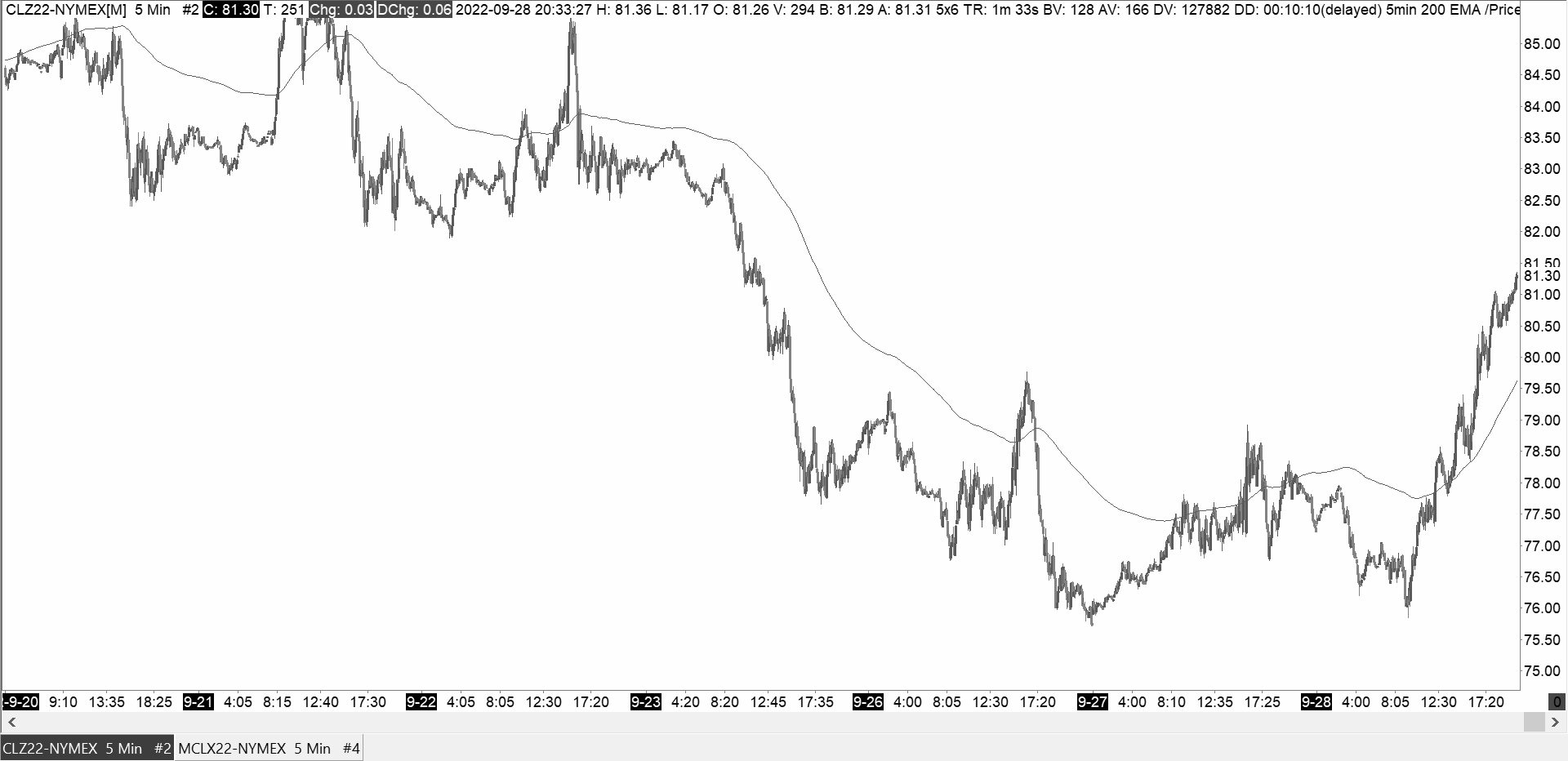

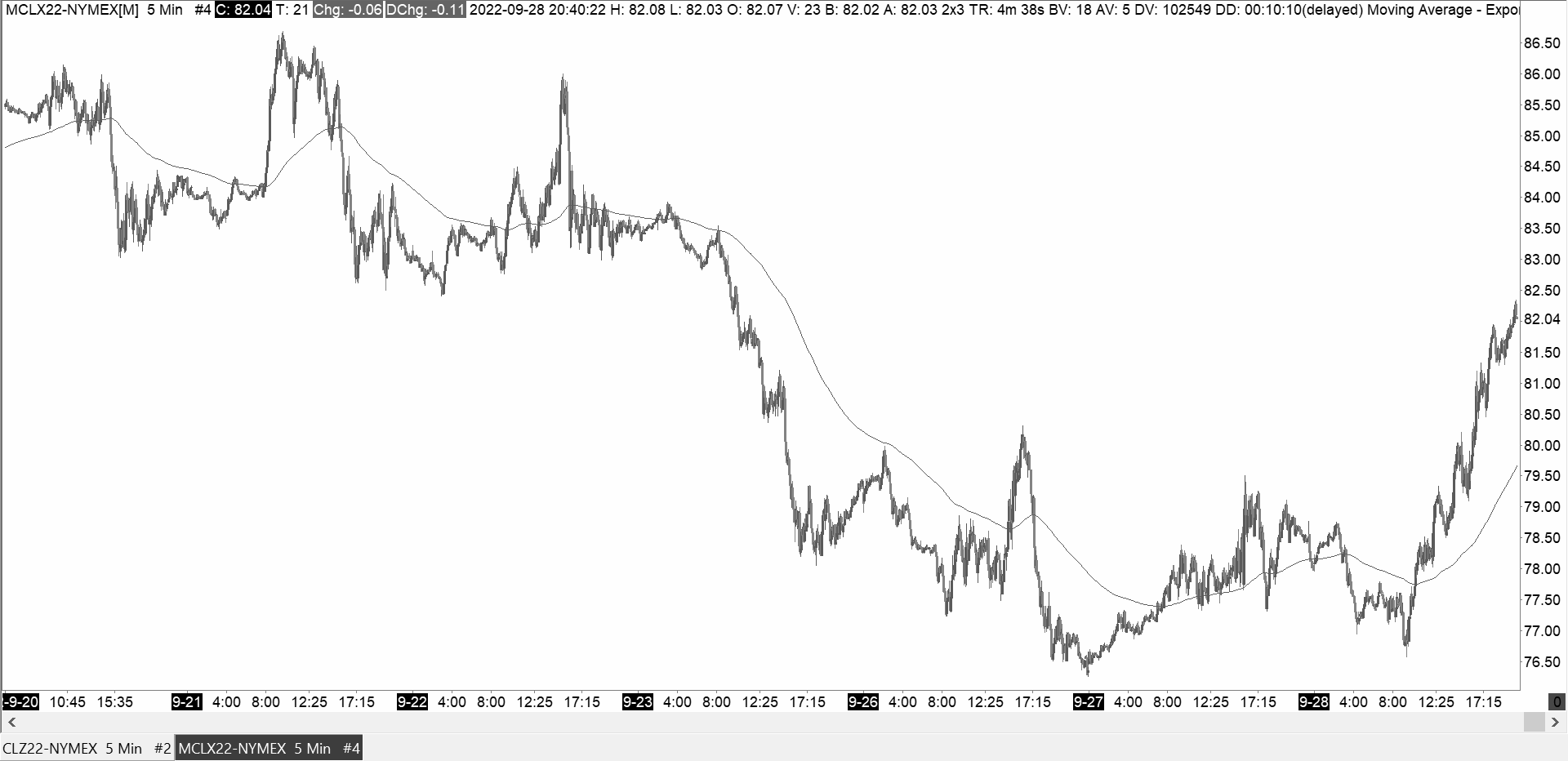

The Moving Average is Displaced on the Main Graph When Using Study/Price Overlay.
has you can see on the link below, I used the 5 min chart of the main graph and the 5 min chart of the chart used to do study/Price Overlay, there is a displacement above the candles on the first chart.
Displaced chart
https://www.sierrachart.com/Download.php?Folder=SupportBoard&download=69870
Chart of how it should be
https://www.sierrachart.com/Download.php?Folder=SupportBoard&download=69873
image28September2022_08PM43_42_337.png / V - Attached On 2022-09-28 18:49:09 UTC - Size: 86.69 KB - 286 views
image28September2022_08PM50_39_803.png / V - Attached On 2022-09-28 18:53:49 UTC - Size: 86.89 KB - 287 views

If you are referring to the vertical displacement relative to the bars, then this is due to the fact that you are looking at two different symbols. The original chart is for the symbol MCLX22-NYMEX and the "displaced" chart is for the symbol CLZ22-NYMEX. As such, the prices are not exactly the same for the bars. From what we see, the Moving Average is correct.
