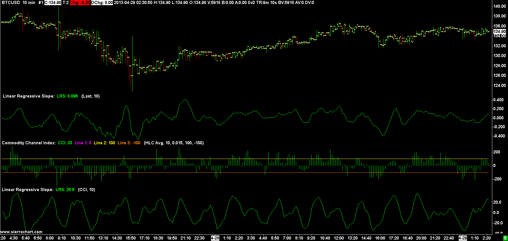

Steps to reproduce:
- insert two studies into a chart: Linear Regressive Slope (LRS) + Commodity Index Channel (CCI). Insert them into different chart regions.
- Go to "Settings" -> "Settings and Inputs" tab of the LRS study
- Change "Based on" from <Main price graph> to the CCI you inserted and set "Input Data" to the "CCI". Confirm.
See the scale and the values of LRS. These should oscillate between -1 to 1 but instead they oscillate in values typical for CCI.
If you change "Based on" to the <Main price graph> in LRS, the values are correct, oscillating between -1 to 1.
Is it a bug or am I doing something wrong? I tried to help myself by changing the scale of the LRS study but nothing helped.

Looks OK for us:
http://www.sierrachart.com/image.php?l=1367270320184.png
The bottom graph is based upon the Commodity Channel Index.

But look at the scale, at the values of the bottom LRS.
On the picture you posted, see the scale of the bottom LRS - I see there are values 20, 0 and -20 ...but that doesn't make sense, I'm expecting a scale with values similar to the first LRS on the picture (in which the scale is from -0.4 to 0.4).
Linear Regressive Slope: LRS: 26.6 (CCI, 10) ---> The actual value of the last LRS on the picture is 26.6 ...that is too much. LRS with such value represent a dramatically steep slope. Such steepness would exist only if there were great jumps in CCI values, but there are none.
