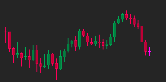

[2022-09-21 04:54:58]
Sawtooth - Posts: 4359
Hide the second instance, and unhide the first instance.
You should see all bars colored except the current bar.
This means the current bar is 0, and all previous bars are 1
The second instance wants to find the bar with the 0, by referencing the first instance using a formula like this: =ID2.SG1=0
When it is working correctly, it should look like the attached pic, before the color is set to match the background.
Now set the color of the second instance to the same as the background, and the current bar will disappear.
imageCurrent bar isolated.PNG / V - Attached On 2022-09-21 04:54:35 UTC - Size: 6.84 KB - 373 views

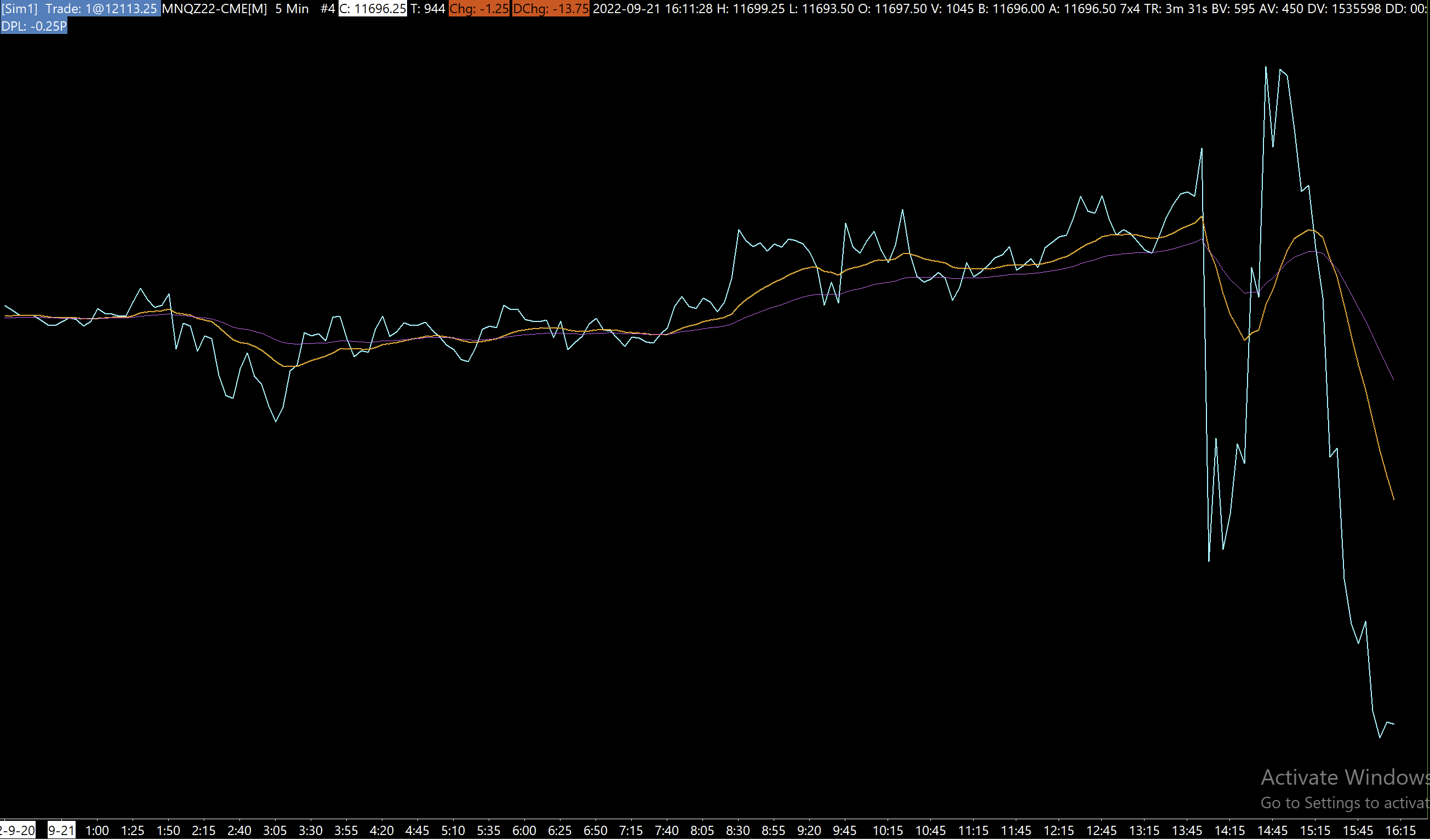

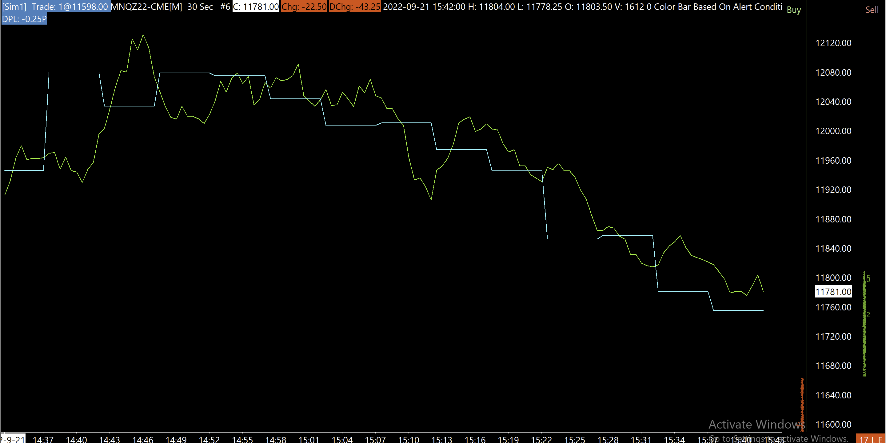

Unfortunately, I wrote too soon. One of the charts still isn't working. Unfortunately, it is the 1-minute chart, the one I want to trade from. With the automatic scale, it gets compressed at the top of the bar. When I try to switch to a user-defined scale, SC instantly switches to my #1 chart. On the 1-minute chart, the the first instance of the Color Bar study is ID2, so the alerts are =C[2]=0 and =ID2.SG1=0.
I tried deleting the 1-minute chart, duplicating the #1 chart, and rebuilding the 1-minute. This time, it appears to have come up on the user-defined scale and is displayed correctly. However, SC won't display the scale-setting pane so I can switch to automatic. This is the image URL, captured as SC now requires.
https://www.sierrachart.com/Download.php?Folder=SupportBoard&download=69640
The following shots are of the 5-minute chart, taken a while ago. (That chart, like all except the 1-minute, is now working correctly.) They fairly represent what I expect would happen to the 1-minute chart if SC allowed me to change the scale setting.
https://www.sierrachart.com/Download.php?Folder=SupportBoard&download=69641
https://www.sierrachart.com/Download.php?Folder=SupportBoard&download=69642
I am sorry to subject you to all this, but help me Obi-Wan tomglib. You're my only hope. (Hmmm. That feels too cute, but whatever.)
