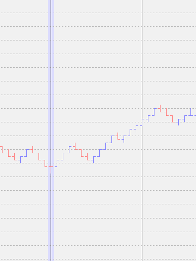

Good day. There are two conditions:
AND (ID2.SG2[-1]=ID1.SG2[-1], ID2.SG2=ID1.SG2, ID2.SG2>2, ID2.SG1=ID1.SG1=0)
and
ID2.SG2<1
When writing conditions to the indicator separately, the Background is marked correctly.
I want to write down a condition under which the alert (Background) turned on on the first condition and continued until the second condition appeared (the area is marked with black lines).
The expression only marks the first bar
=IF (AND (ID2.SG2[-1]=ID1.SG2[-1], ID2.SG2=ID1.SG2, ID2.SG2>2, ID2.SG1=ID1.SG1=0), 1, IF ( ID2.SG2<1, 0, 0))

Sawtooth - Posts: 4359
You must create a persistent TRUE until the second condition, like this:
=IF (AND (ID2.SG2[-1]=ID1.SG2[-1], ID2.SG2=ID1.SG2, ID2.SG2>2, ID2.SG1=ID1.SG1=0), 1, IF ( ID2.SG2<1, 0, ID3.SG1[-1]))
where ID3 is the Color Background study.
