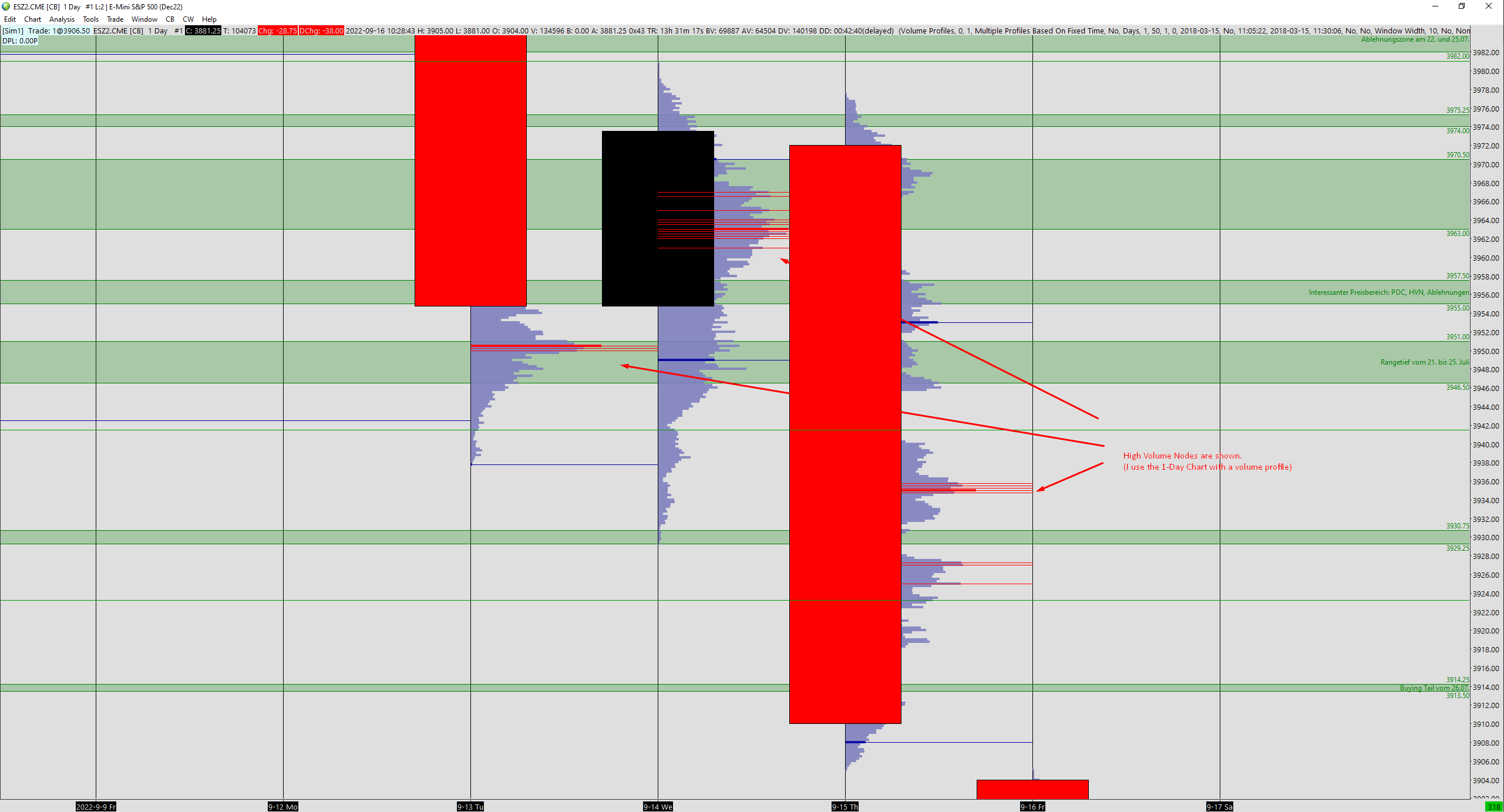

Dear Ladies and Gentlemen,
I'm currently in the process of familiarizing myself with creating studies with ACSIL. For this I have now created a study in which I mark high-volume-nodes with a "LineUntilFutureIntersection". This also works fine after adding the study(see attached picture). However, I don't want the lines to be added again with "AddLineUntilFutureIntersection" after each recalculation of the chart, as i saw that the return value of "GetNumLinesUntilFutureIntersection" gets bigger after each recalculation (line 35 of attached file).
So I thought I could call the "DeleteLineUntilFutureIntersection" function when sc.Index == 0 and delete all lines. (lines 38 - 47 of attached file). The problem is that "sc.DeleteLineUntilFutureIntersection()" always returns 0 and no line is deleted...
I tried a lot and then noticed that in line 55 (GetStudyLineUntilFutureIntersection), there is also 0 returned on recalculation, whereas previously (after adding the study/no recalculation) in line 104 a 1 is returned with the same function call...
Can you please tell me what I'm doing wrong here? I'm just getting a bit desperate.
Thank you and best regards
Thomas
