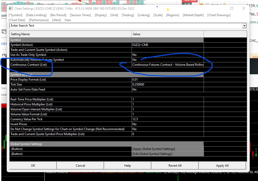

John,
FYI just a little while ago someone in the SierraChart Discord room made a suggestion and it appears to have worked. The key is to make sure the Continuous Contract (list) input in Chart Settings, Symbols is set to "continuous futures contract - volume based rollover." That appears to have solved my chart issue after the roll to ESZ22.
The attach chart function to this board is difficult to figure out. I thought I had followed your instructions from a week ago and really had no idea whether or not the chartbook you asked for was actually transmitted to you.
Thank you for your help, but I believe the above solution worked.
imageImportant Relative Volume Chart Setting under SYMBOL setting.jpg / V - Attached On 2022-09-20 18:35:32 UTC - Size: 170.3 KB - 250 views
