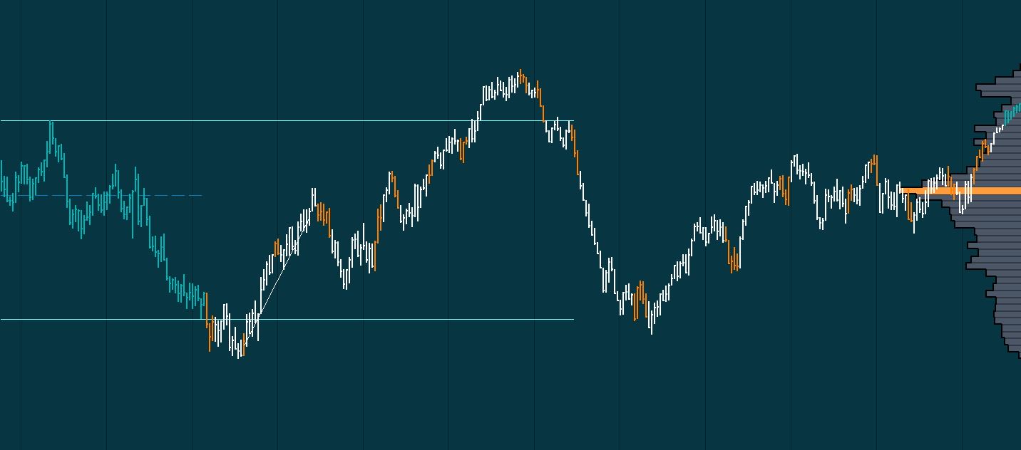

Hey,
For the purpose of manual backtesting, I am looking for a way to extend the overnight POC until 12AM. I'm currently calculating the POC by using a Volume By Price study on a secondary chart that is set to only show ETH, and overlaying the lines on my main chart using a Study/Price Overlay.
I know this should be possible with a simple Spreadsheet Study, but I'm really struggling here.
I have attached an image where you can see my overnight H&L levels extending all the way to 12AM, and my overnight POC (blue dashed line) stopping at 9:29:59.
Any help would be more than welcomed.
imageOVERNIGHT-LEVELS.png / V - Attached On 2022-09-10 10:09:48 UTC - Size: 39.36 KB - 263 views

I have managed to do it on my own.
The trick was to add a 'Horizontal Line at Time' study to my ETH chart, base it on the Volume By Price study that was giving me the overnight POC, set it to dash, set the desired time and extension, and then overlay it on my main chart using a Study/Price Overlay study, in case someone wants to do the same thing.
