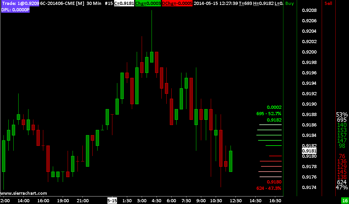

Upgraded from v1132 to 1135 and noticed that in the chart DOM Depth Total and Depth % values are printing nearer to the bid & ask, whereas they used to appear at the other end of the DOM list. The issues only arises with currencies ( DX, 6E, 6B etc) the other commodities I trade show the Depth Total and % in the same location as previous versions of SC.
Problem is that for currencies the Total and % are now superimposing and mask the underlying values.

Based on this description, there is a problem with the market depth data itself. You can confirm that by going to File >> Open Market Depth Window. There must be an out of order price.
Select File >> Disconnect and File >> Connect to Data Feed to see if it corrects this.
We think that if you went back to an earlier version you would still see the problem.

[2014-05-15 16:29:15]
We have run a test and the data display looks correct:
http://www.sierrachart.com/image.php?l=140017126898.png
This is with the Sierra Chart Exchange Data Feed.

Marmany - Posts: 319
Display is correct in the File>> Open Market Depth Window.
Disconnect and reconnect does not solve the problem.
I find it strange that problem only occurs with currencies.
6B chart illustrates
http://www.sierrachart.com/image.php?l=1400178697340.png
Please advise if you have any other ideas as to how to rectify.
[2014-05-15 18:51:38]
We have identified this as an issue with the data from TransAct. We are going to report the problem to them.
Also we clearly see a problem with the depth in the Market Depth Window. The levels are out of order and repeating.
