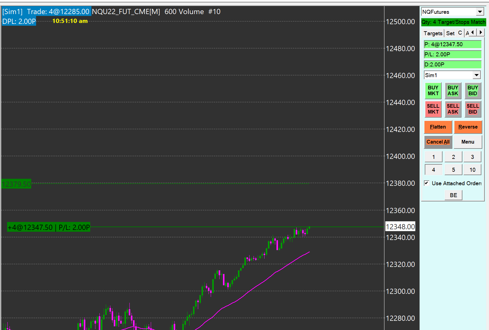

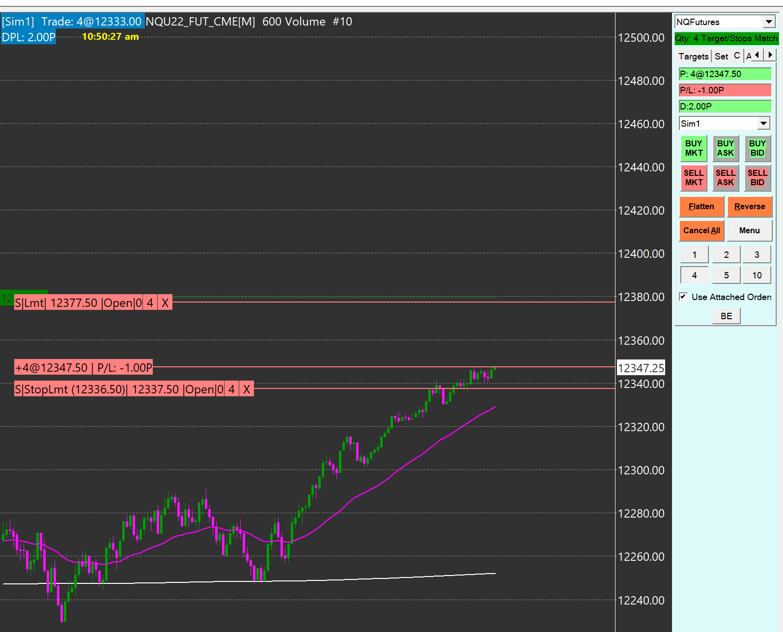

When in sim mode and placing an order with chart trader, everything works as it should, I have my original order with stops and targets attached. When I click "Show Fills" briefly all the order lines go away (positions, stops and targets) and the only thing that comes back is the original position, stops and targets are no longer showing.

Can you please provide us a "Before and After" pair of images so we can see what you are seeing.
[2022-09-08 20:54:56]
Tonkadad - Posts: 235
File attached
imagejust after Show Fills.png / V - Attached On 2022-09-08 20:52:44 UTC - Size: 77.96 KB - 206 views
imagePlace order.png / V - Attached On 2022-09-08 20:53:08 UTC - Size: 94.66 KB - 287 views
