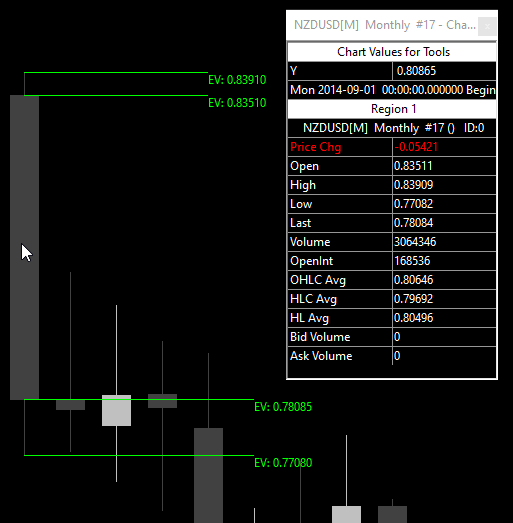

[2021-07-01 17:35:02]
User676363 - Posts: 90
Fun thread. Hope everybody has recovered. That was tense.
I'm here to shake the tree some more but I have a temporary solution, so I promise to be gentle...
I wanted to mark the chart by placing a box (like the chart values for tools with just OHLC) on various candles on the chart for printing purposes.
The image attached shows my solution. I created a custom button called Price Label and used the Custom Tool feature to select Chart Calculator and a Tool Config that only selects Price [EV].
This allows me to label a candle rather quickly, but still 400% more clicks than I would like to take.
I feel I should be able to draw one line and have a box appear that I can configure with things like date, OHLC, and perhaps other things on the chart value for tools and chart calculator...
That way, I could quickly label a few important candles, generate an image and post it/print it, whatever.
1) Thoughts on how to do this better?
2) I have attached a screenshot showing what I have done. Notice that even though the chart calculator has snapped to position selected, it gives different values for OHLC than are presented in the Chart Value for Tools window.
Thanks Guys. Sierra Chart rocks. Even if it doesn't yet let me drag a tweet onto the screen, expand the tweet to make it beautiful and make it appear over a candle with the specific date and time like Tradingview does: https://www.tradingview.com/blog/en/tweets-on-the-chart-25072/ And I can't yet search for anything in the menu or dialogs like I can on my iPhone settings, but I still find it very powerful... Really appreciate the work you have done.
imageSierraChart_64_2021-07-01_19-18-29.png / V - Attached On 2021-07-01 17:23:48 UTC - Size: 18.19 KB - 647 views
[2021-07-01 19:16:24]
John - SC Support - Posts: 48633
We have tagged this as a Feature Request.
