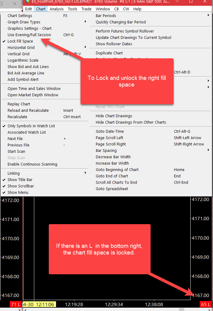

For # 2 - While on a chart, the menu "Chart" has an item Lock Fill space. I suggest you insure it is not checked. slide the barsto the let / right to get the blank space you want on the right of the chart. Then go to the menu item and "Lock" the fill space. Also, if your chart is not all the way to display the last / current bar, the box on the bottom will be red. When you are displaying the current / last bar, the box will be green.
Hope this helps,
JohnR
imageSC_Forum_lock_Fill.jpg / V - Attached On 2022-09-06 19:08:21 UTC - Size: 229.6 KB - 197 views
