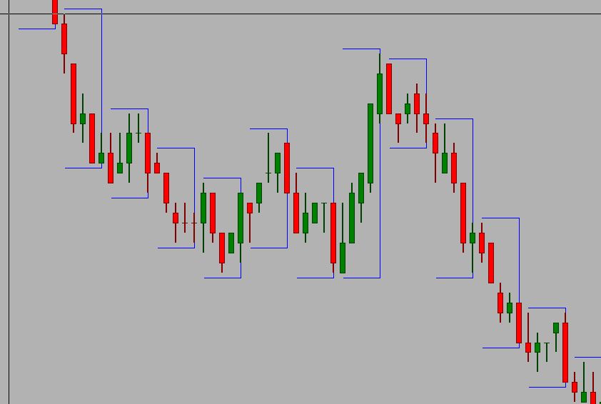

Jupitersbay - Posts: 54
The "Draw Profil Outline Enclosing Bars" option in the Number Bars study creates only three lines as outline, not a complete rectangle (see attachment).
Is there an option to create complete rectangles?
imagesc closing volume profile.jpg / V - Attached On 2022-09-06 09:51:00 UTC - Size: 27.82 KB - 215 views

John - SC Support - Posts: 48209
From what we can see, you must be referring to a Volume by Price study in which you have the option for Draw Profile Outline Enclosing Bars set to Yes. But you also must have the option for Volume Bars Draw Method set to Volume Profile Outline Only as that is the only way to get what you are seeing.
The reason for this is that the other drawing options all have a base line drawn on the base side of the profile. Therefore, there is generally not a need for that side to be drawn, as it is already covered, except in the above situation with the Volume Profile Outline Only is used, as that does not draw that base line.
We have set this as a Feature Request, but this is not something that we will get to anytime soon.
Thats wonderful.
You know, what would be even better?! If the rectangle around the bars would enclose the whole bar, not only half of the first and half of the last bar.
That looks extremely cool and clean. I enclose a screenshot.
I am well aware that this might be a complete change in the coding. So, I am sure you will do, what is best for the product.
i forgot the screenshot.
imageScalptrader.jpg / V - Attached On 2022-09-06 22:35:32 UTC - Size: 120.45 KB - 289 views

Sierra_Chart Engineering - Posts: 25177
Yes you are referring to a Volume by Price study and we will add the left side of the outline rectangle.
That will be out in the next release. Hopefully it does not generate any complaints though. But if so we can always add an option for it.
