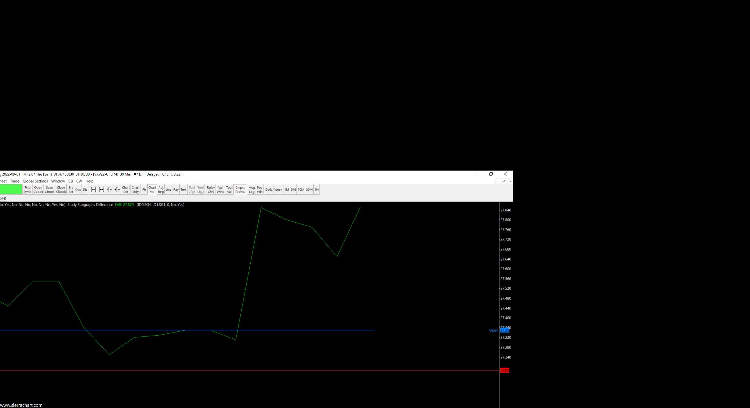

Was wanting to display Study Subgraphs Difference as the Main Price Graph. But when doing so (in the Settings), the main price axis prices stays from the main chart and does not use subgraph price axis. I tried changing the price scale, gut couldnt find any settings that would make it work.
https://www.sierrachart.com/image.php?Image=1662059460352.png
https://www.sierrachart.com/image.php?Image=1662059529299.png
[2022-09-01 20:47:46]
We are not understanding the particular issue. It appears that the "Study Subgraph Difference" is properly displayed in the Main region (region 1). The last bar from the Study Subgraph Difference has a value of 27.87, so we assume the green line is the study subgraph difference.
If we are missing something, please give us more information on the exact issue.

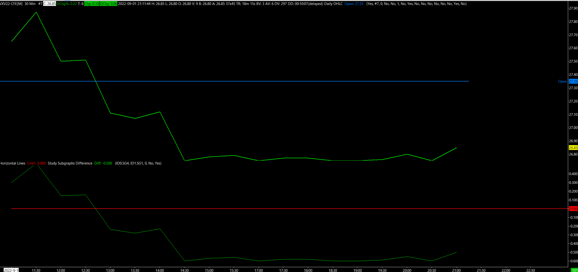

[2022-09-02 02:31:35]
User841161 - Posts: 357
Sorry, didnt realize I sent such a bad picture of charts. Have multiple monitors so not sure how to do screen images through Sierra Chart when having multiple monitors. The spread values(axis) should be decimal form mostly between 1 and -1-like in picture -.52. So when try use Spread as Main Price Graph, it doesn't use the the smaller numbers that the subgraph has (.52) it still uses the Main Price Chart prices for the price axis.
imageVXSpread.png / V - Attached On 2022-09-02 02:31:25 UTC - Size: 92.47 KB - 301 views
[2022-09-02 18:14:59]
We are not sure. Please get us a copy of that chart in a chartbook of its own by following these instructions:
Make sure that when you copy the chart it continues to show the same issue.
[2022-09-02 19:54:54]
you will have to go into study subgraph difference and Change Chart to Region 1 and check mark Display As Main Price Graph. After doing so look at price axis, it doesnt change, it still using main price price axis, or doesn't take on subgraph price axis(which I want).
attachmentVXSupport.Cht - Attached On 2022-09-02 19:53:41 UTC - Size: 3.67 KB - 300 views
[2022-09-02 20:12:27]
The problem is that your Study Subgraph Difference is setup to compare the Main Price Graph Close against the Daily Close. So when you set the Study Subgraph Difference as the Main Price Graph, it is now trying to do the difference between itself and the daily close. So you can not do what you are doing.
If you want to see the Study Subgraphs Difference in the first region, then you would need to just display it in Region 1. It is then up to you as to what other items to show and how to scale it.
