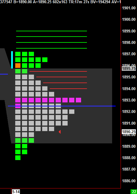

I would like to have the Value Area Highlighted on a TPO Chart.
Since I don't see a place to do this in the Study Settings (I did see Extend Value Area to end of Period/Window), I added a TPO Value Area Lines Study to the chart and used Trans Fill Bottom/Top to fill in the space.
However, the shaded area does not seem to the match the grey boxes which I would think would match. It's close but not the same. They both have a 70% setting so I am not sure what is throwing them off. Any suggestions?
image1234.png / V - Attached On 2014-05-14 14:43:01 UTC - Size: 15.55 KB - 696 views
[2014-05-14 16:29:36]
You cannot use the TPO Value Area Lines study on a TPO Profile Chart.
In the image attached, the value area is already highlighted on the profile with the gray color. The only other thing you can do is draw extension lines that extend forward.
