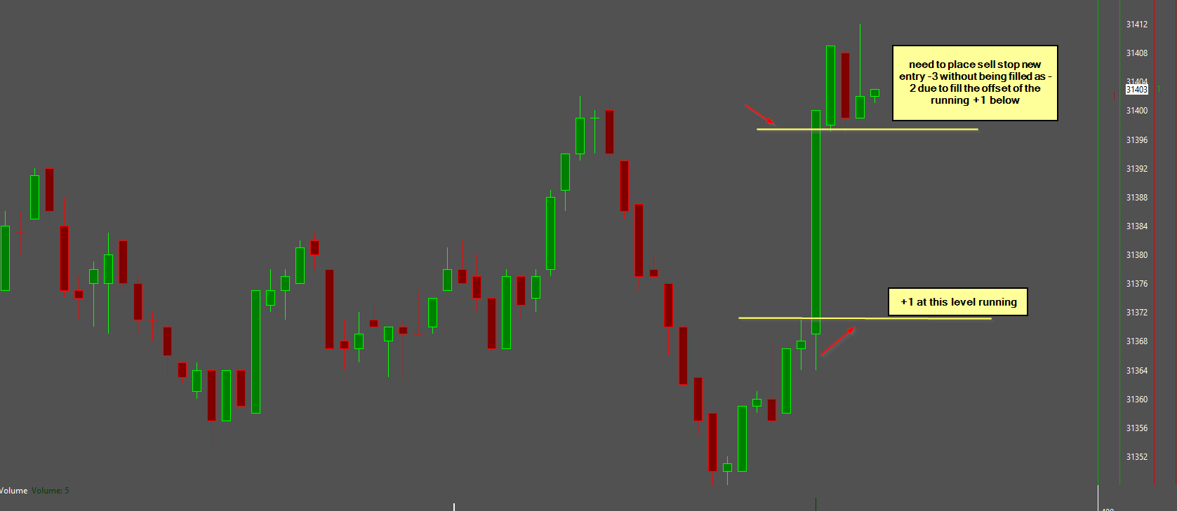

[2022-09-01 18:42:15]
User190501 - Posts: 98
I have attached a chart to explain it better than text.
image2022-09-01 14_35_45-.png / V - Attached On 2022-09-01 18:38:10 UTC - Size: 46 KB - 298 views
[2022-09-01 18:56:02]
What we said above still stands based on your figure. Is there something we are missing with what we stated?
[2022-09-01 19:48:22]
The point is that u maintain the same quantity number at each entry .. now second entry would be -2 and this is not -3 -- so how come this resolved the issue -- you need each new entry as a reversal like if u have a spreadsheet or ACSIL reversal entry --- each new opposite entry when filled will flatten any other existing positions -- Hope this is clear now .
