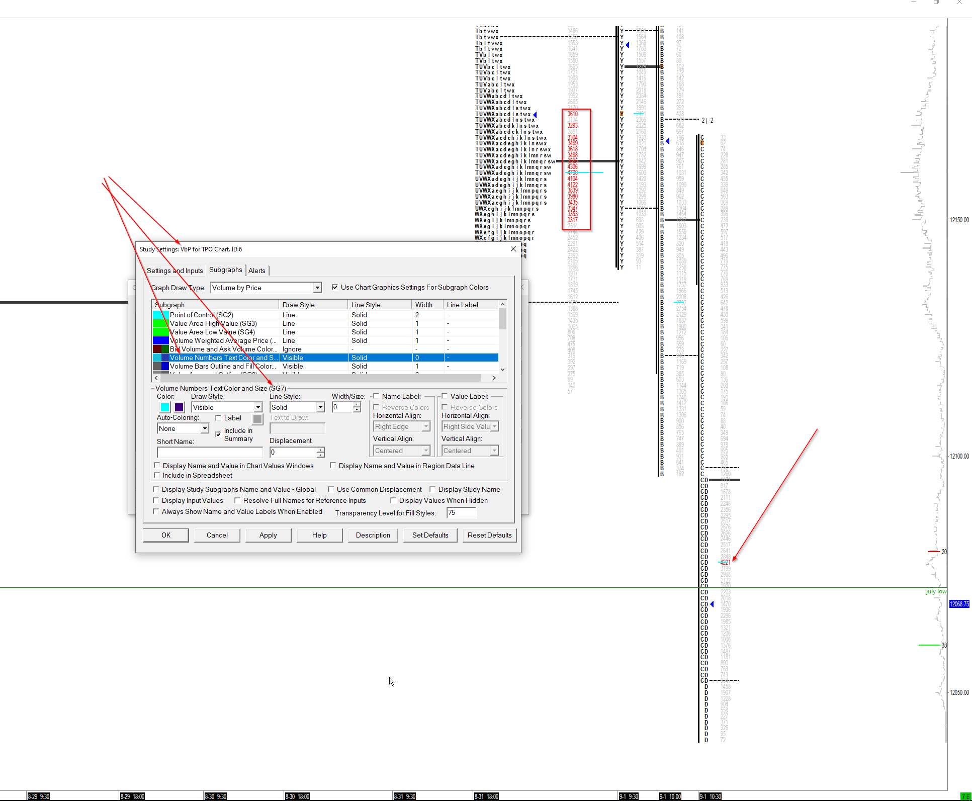

can somebody tell me a simple alert formula for the following scenario:
VbP study volume threshold in the TPO profile. See attached file.
by the way: Im trying this for weeks now by myself by reading the sierra documentation. but obviously i'm just too stupid and Im really getting nuts about this with all the possibilities.
Im begging you. help me. :)
will be very grateful.
M.
Date Time Of Last Edit: 2022-09-01 15:27:07
image2022-09-01 17_17_59-.png / V - Attached On 2022-09-01 15:27:00 UTC - Size: 213.26 KB - 202 views

Do not worry about the specific studies. Just tell us what exactly you want to accomplish. For example: 'I want an alert to go off when the total volume at a price level is above 100'.
We can then point you in the right direction as to how to do whatever it is you want to do.

'I want an alert to go off when the total volume at a price level is above 3000'. (VbP study)
thank you
[2022-09-01 18:47:42]
You can not use the VbP to do this. Rather, what you need to do is to have a separate chart (there is a limited set of studies that can be used with the TPO study) set to the bar period for which you want to capture the data, and use the Volume at Price Threshold Alert V2 on that chart.
