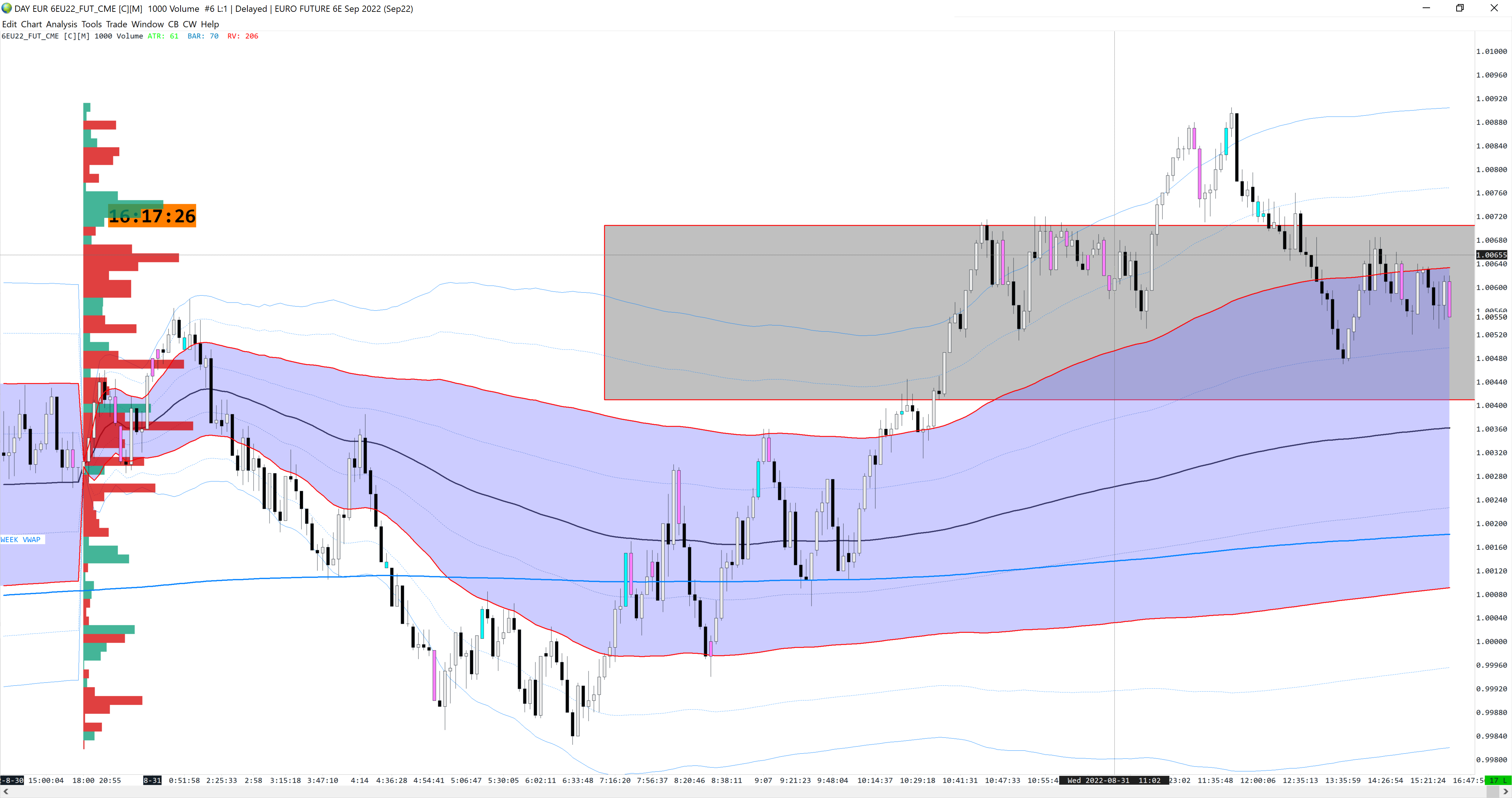

Hi I have copy config label to text for extending rectangles for the rectangle have market profile as a name and is not working.
I set up already that option from global settings, tool config and nothing.
imagetest.png / V - Attached On 2022-08-31 20:20:55 UTC - Size: 654.07 KB - 294 views

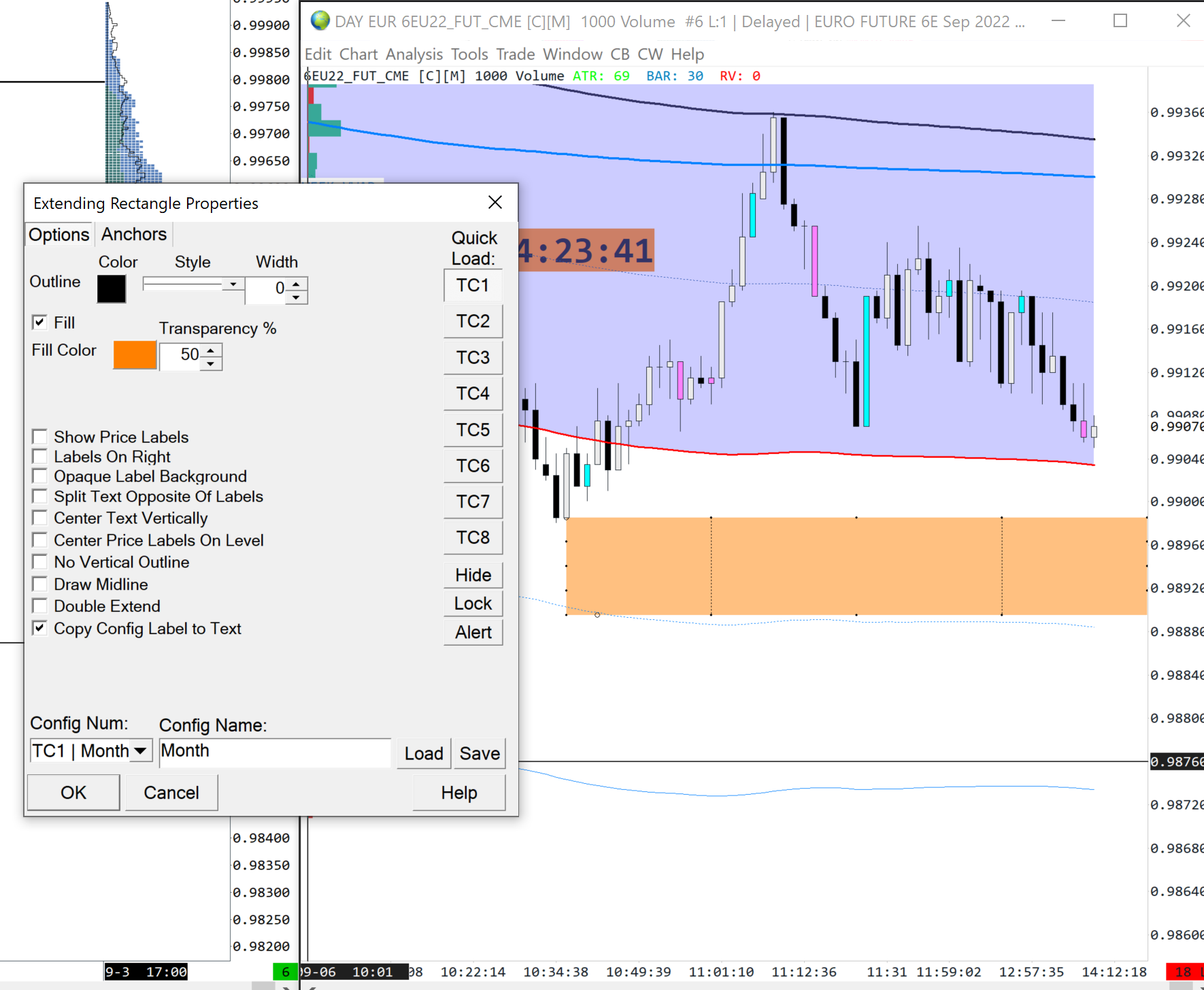

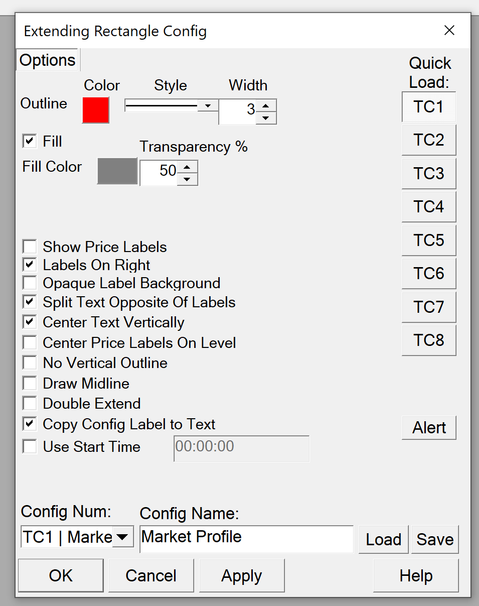

Here the general settings configuration
imagegeneral1.png / V - Attached On 2022-09-02 01:09:12 UTC - Size: 244.15 KB - 231 views
imagegeneral2.png / V - Attached On 2022-09-02 01:09:17 UTC - Size: 78.15 KB - 208 views

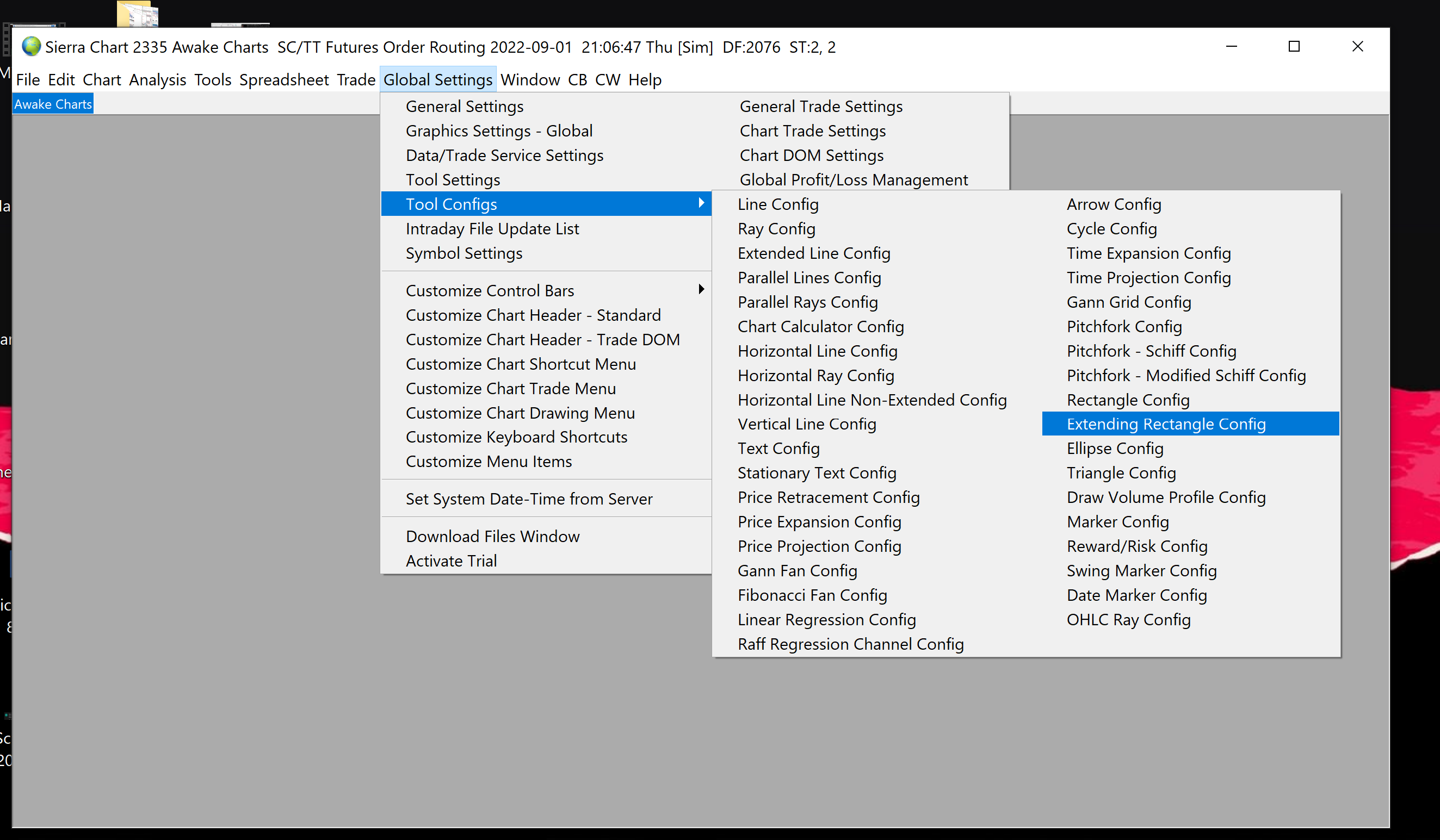

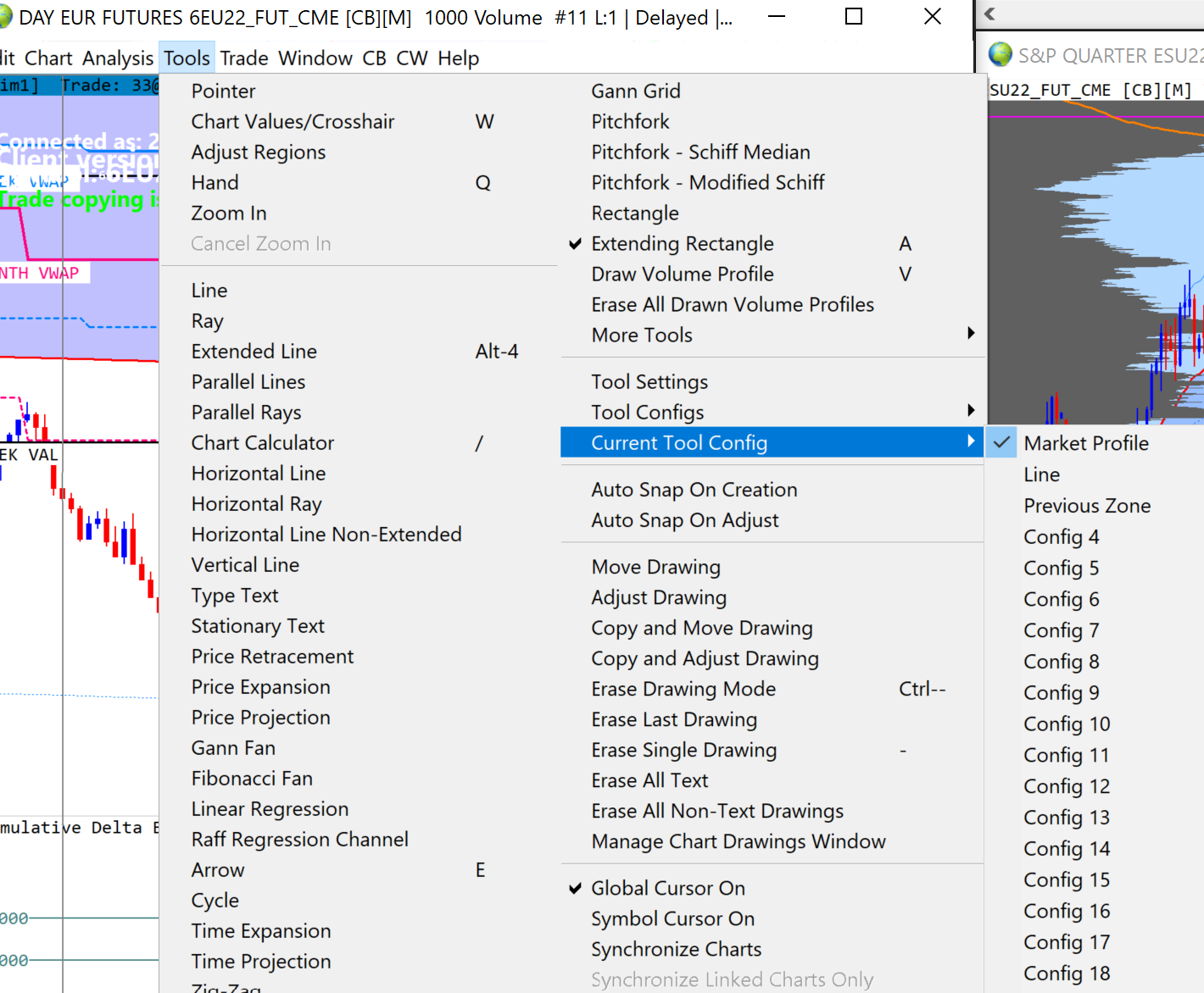

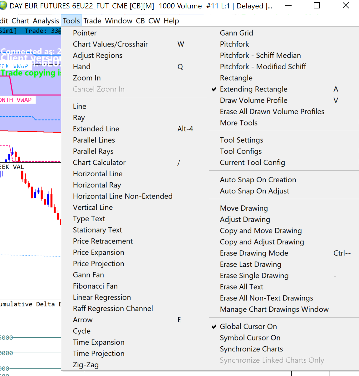

Here when I select the tool
imagetool1.png / V - Attached On 2022-09-02 01:12:03 UTC - Size: 398.8 KB - 271 views
imagetool2.png / V - Attached On 2022-09-02 01:12:07 UTC - Size: 487.71 KB - 278 views
imagetool3.png / V - Attached On 2022-09-02 01:13:28 UTC - Size: 176.21 KB - 198 views

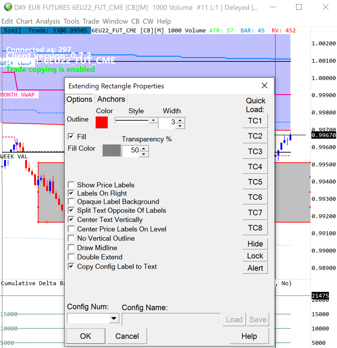

Drawing properties after I draw it
imagetool4.png / V - Attached On 2022-09-02 01:13:56 UTC - Size: 343.63 KB - 220 views
[2022-09-02 17:58:08]
Everything looks good in terms of the setup you should be using to get what you want. But what is interesting is that the Drawing Properties window is not showing the configuration name, which it should.
Please try the following:
- Draw the rectangle and then select the "Drawing Properties" for that rectangle. Select the button for TC1 in the upper right. Let us know if the configuration name shows up in the bottom for the Config Name.
Also try the following:
- Open the configuration (Tools >> Tool Config >> Market Profile) and without changing anything verify that the name is displayed in the Config Name field at the bottom.
[2022-09-02 23:32:50]

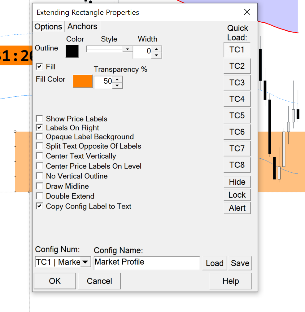

awakef - Posts: 72
Yes the configuration name appears on the bottom.
imagemarket.png / V - Attached On 2022-09-02 23:32:15 UTC - Size: 209.66 KB - 208 views

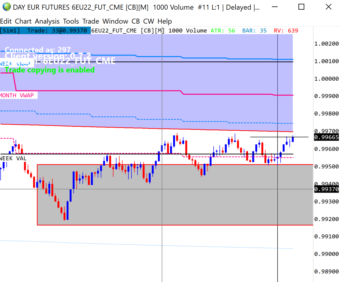

Please uncheck the option for "Labels on Right" in the configuration and then try drawing the rectangle again. Let us know if the name is displayed on the left side of the rectangle.
[2022-09-06 18:24:53]
awakef - Posts: 72
Nothing
imageScreenshot 2022-09-06 142430.png / V - Attached On 2022-09-06 18:24:39 UTC - Size: 446.3 KB - 281 views

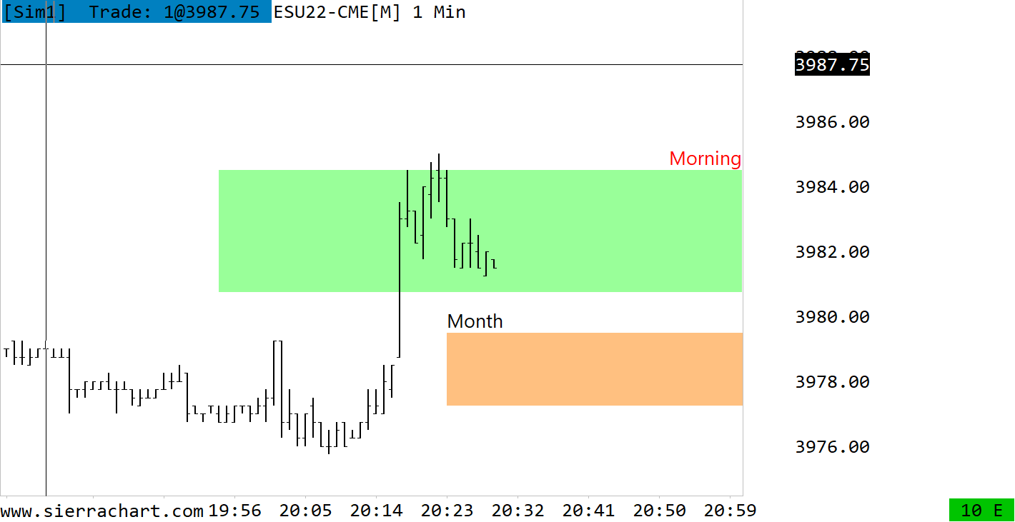

Unfortunately, it works fine for us. The following link is an image showing two of the rectangles:
https://www.sierrachart.com/image.php?Image=1662597066612.png
Let us know when we could call in order to connect to your system and see if we can figure out what is occurring. Be sure to specify the time zone.
