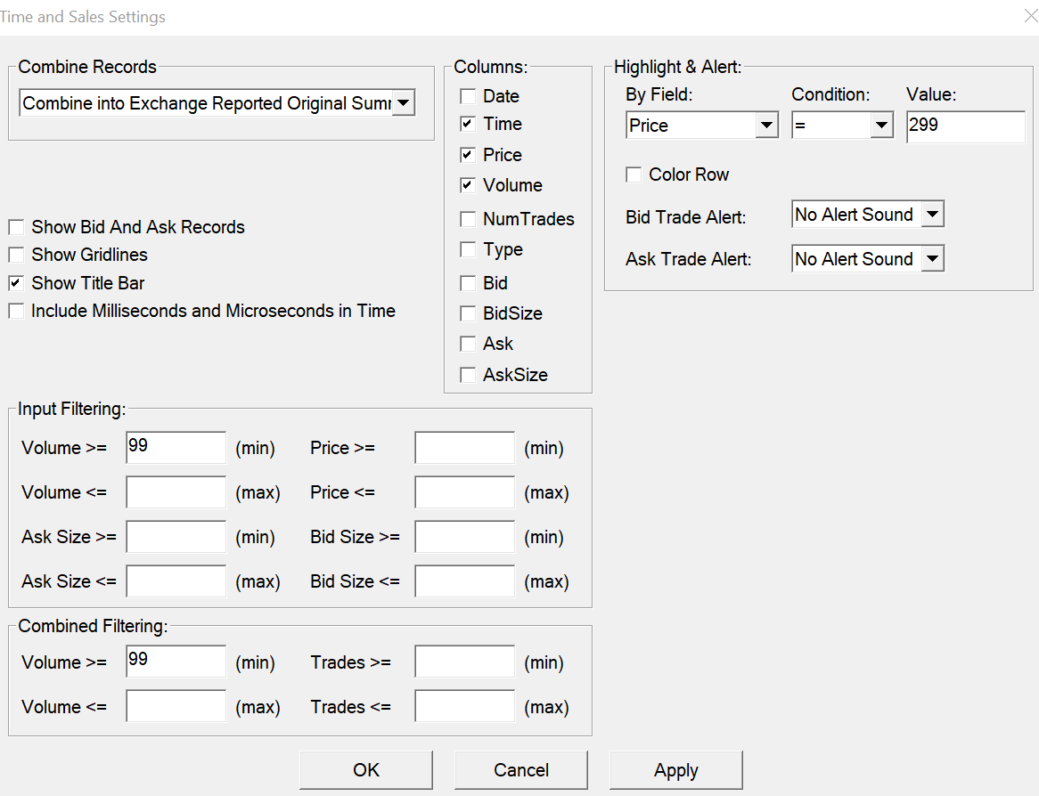

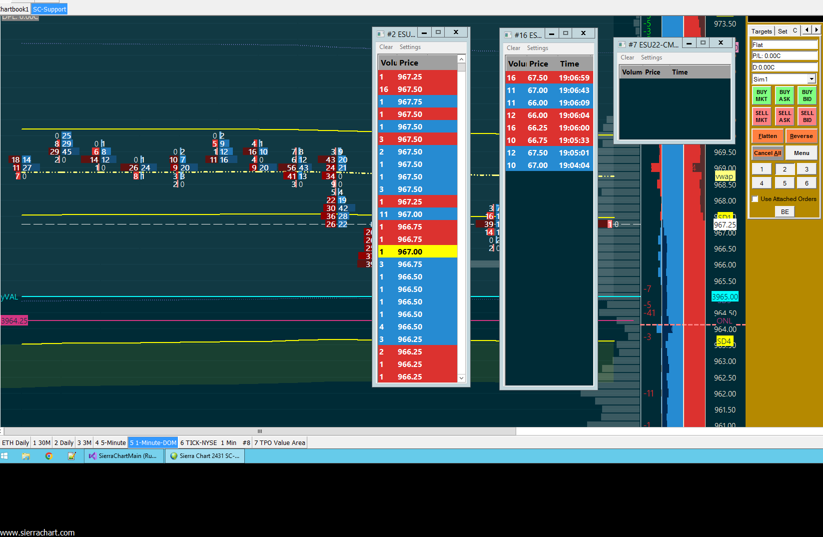

Hi, I am running Sierra Chart version: 2425. I have a time and sales window which is set to 'Combine into Exchange Reported Original Trade' and I have my 'Combined Filtering' set to >= 99 (min). However, as you will see, my time and sales window is still showing 1 lots randomly. I have attached a screenshot of the settings and the tape. Just an FYI, I did remove the 99 from the 'input filtering >= (min)', but the issue still persists.

You would want to keep the 99 for the "Input Filtering >= (min)". The reason for this is that the Combined Filtering only filters out those trades that have been combined. Therefore, if you want to filter out all trades (combined or not) that are less than 99, then you would want to have both those fields filled out.
This should work. Be sure that after you make the change and have your filtering set as you want, that you Clear the Time and Sales window to ensure that you are not seeing data from before you made the change to the filters.

John - SC Support - Posts: 48459
The following link is what we saw tonight (19:07 Central US time) for your chartbook. We changed the filtering to be 10 instead of 20 in order to get a few extra lines. Everything is working as it should. So we do not see any issue as long as both the Input filtering and the Combined filtering are both set to the same value (10 in this case).
https://www.sierrachart.com/image.php?Image=166207722346.png
We will try to take a look during the trading day when there is more activity to see if anything comes up.
