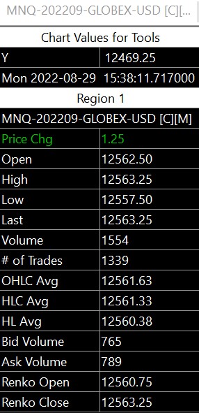

Fanch - Posts: 20
I used Flex Renko Inverse Set with settings of 10-4-20 using Edit >> Export Bar Data and Studies to Text File.
In export file:
Datetime 2022-08-29 15:38:11.717
Open 12562.5
High 12563.25  (= Renko Close)
Low 12560.75  (= Renko Open)
Last 12563.25
In Chart Values for tools window (see attached screenshot):
Open 12562.5
High 12563.25
Low 12557.50
Last 12563.25
On that specific bar, the Renko Close is equal to the High, so you can't tell it's pulling the wrong value. It manifests itself on other bars though.
