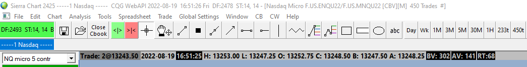

[2022-08-22 14:53:02]
User525965 - Posts: 180
My chart is attached right now and there is no high, low, open, close, bid, ask, etc at the top. This is part of my global settings so not sure why its not showing. Only having the issue with this chart in particular. 2nd attachement is what I want to see.
imageScreenshot_2.png / V - Attached On 2022-08-22 14:52:54 UTC - Size: 3.14 KB - 233 views
imageScreenshot_1.png / V - Attached On 2022-08-22 14:52:59 UTC - Size: 18.53 KB - 219 views
[2022-08-22 15:00:26]
Sierra_Chart Engineering - Posts: 25348
Check this particular setting in Chart Settings:
Chart Settings: Region Data Lines (List) (Chart >> Chart Settings >> Regions >> Region Data Line menu)
[2022-08-22 15:53:02]
that worked, thank you

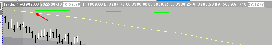

[2022-08-30 15:01:34]
how do I remove the trade 1 from my title bar? sometimes I click on it by mistake
imageScreenshot_1.png / V - Attached On 2022-08-30 15:01:30 UTC - Size: 9.59 KB - 272 views
[2022-08-30 18:13:22]
When the Chart is in Trade Mode, then there is not a way to remove that Trade Mode Box.
