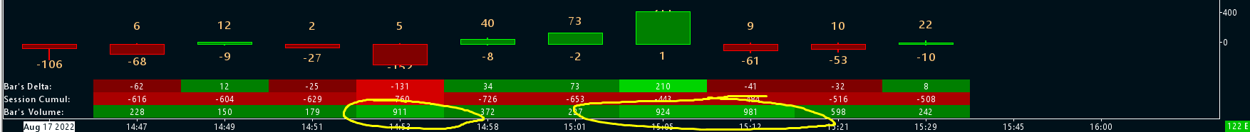

I have been trying to solve this but can't do it on my own.
So what I want is when Numbers bars calculated values and specific the Bars volume print an extreme(Light green) I want to get an alert.
Hope someone know how to solve this and is kind enough to help me out.
imageBars volume.png / V - Attached On 2022-08-17 13:34:12 UTC - Size: 20.86 KB - 248 views

John - SC Support - Posts: 48429
There is not a way to create an alert based on the color itself. You would have to recreate the condition that creates the coloring you want.
In the case of the coloring of the Numbers Bars Calculated Values, you would need to know the Highest and Lowest values over the period in order to determine if a value falls into the particular percentage.
One way we can think to do this would be to use the Highest High/Lowest Low over N Bars study with the Based On set to the Numbers Bars Calculated Values study, to get the Highest and Lowest values over a period of time and then use those to determine your percentage in an Alert Condition. Refer to the following:
