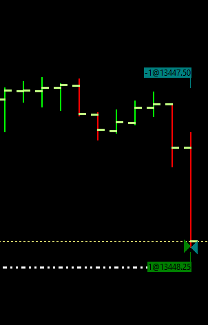

tuanluu20902 - Posts: 24
I've been running into a problem while doing the Live backtest replay with time charts, an issue that I don't run into with tick charts. After an entry, it seems that the algo would auto flatten. I can't find the source to where it would do something like that, that would only happens on time charts and not tick charts.
Do you happen to have heard of something similar or encounter something similar?
imageScreenshot 2022-08-19 191712.png / V - Attached On 2022-08-19 23:17:25 UTC - Size: 3.95 KB - 301 views
[2022-08-20 00:39:58]
Sawtooth - Posts: 4361
Not specifically.
Check the Trade Service Log for why the spurious exit occurred.
