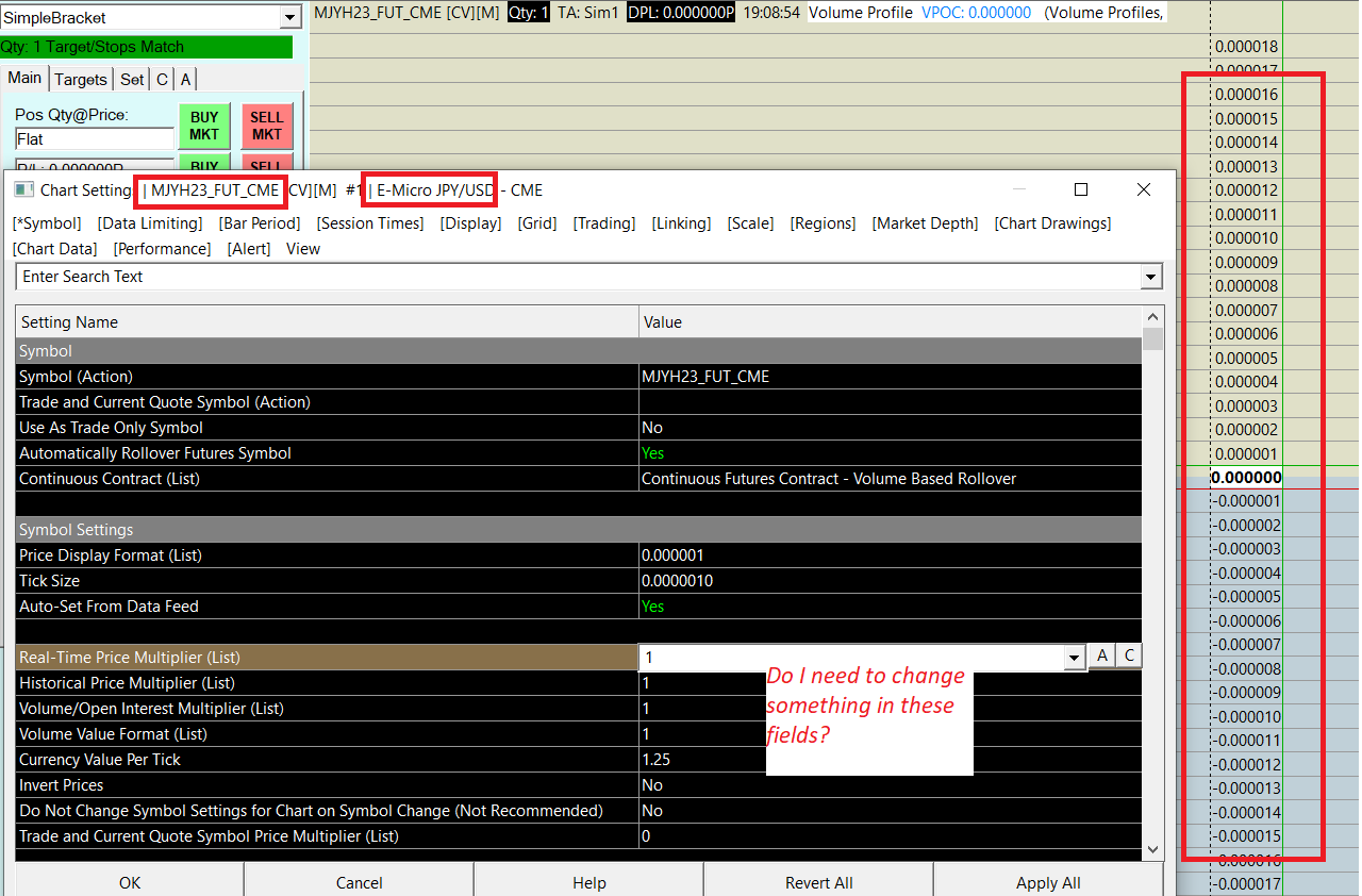

[2022-12-29 17:20:01]
Radu Sirbu - Posts: 40
Hello guys,
Please help on this issue. I really don't know how to fix this on micro-yen DOM.
I attached another screen-shot. Please tell me if I need to make any changes on these fields.
imagequtoes displayed incorreclty.png / V - Attached On 2022-12-29 17:19:29 UTC - Size: 71.81 KB - 261 views
[2022-12-29 18:16:59]
The symbol MJY was delisted back in March of 2022. Refer to the information here:
https://www.cmegroup.com/notices/electronic-trading/2022/02/20220221.html#dmcyusd
As they state, you should use the M6J symbol instead.

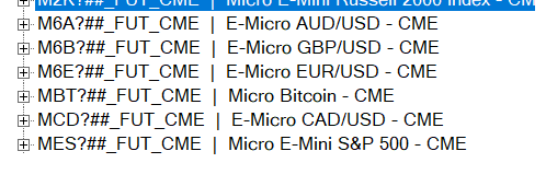

[2022-12-30 15:06:21]
I want to add that I talked with the broker (Edge Clear) and they said it seems to be an issue within Sierra, b/c from their side they simply pass through whatever symbols are available through the Teton service.
They ask if any update needs to be done to Sierra to include the new symbol?
I attached a screenshot with the micro-symbols available in my list.
imagem6j missing.png / V - Attached On 2022-12-30 15:05:31 UTC - Size: 10.41 KB - 195 views
[2022-12-30 17:17:12]
We have to add the symbol information for M6J for the Teton Order Routing Service. It usually takes a day or two for this to get done.
