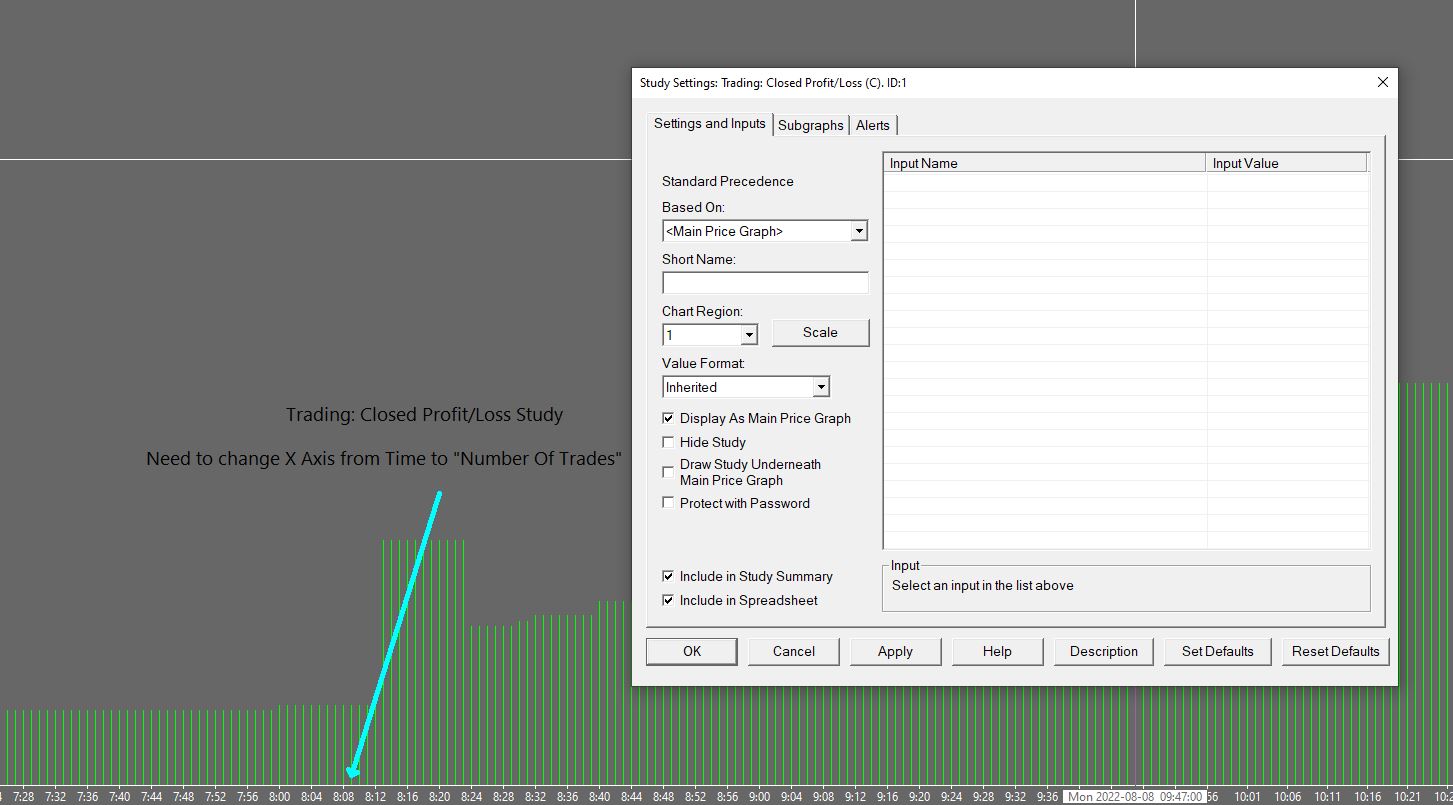

I am using the Trading: Closed Profit/Loss study and made it the main graph. However, I am unable to change the X axis to view the number of trades, instead, it shows only the time on X axis. Is there a way I can change the X Axis to display number of trades for this study.
Thank You,
imageFor Sierra Chart Support_Rev2.JPG / V - Attached On 2022-08-08 23:31:21 UTC - Size: 140.26 KB - 333 views
[2022-08-09 14:07:17]
You can not change the x-axis. It is always a time scale.
You could add the Trading: Total Trades study to the chart and hide it, then use the Study Subgraph Above/Below Bar as Text study to display the information above/below the bars for the Profit/Loss study. Just be sure to set the Based On for the Study Subgraph Above/Below Bar as Text to be the Profit/Loss study.
