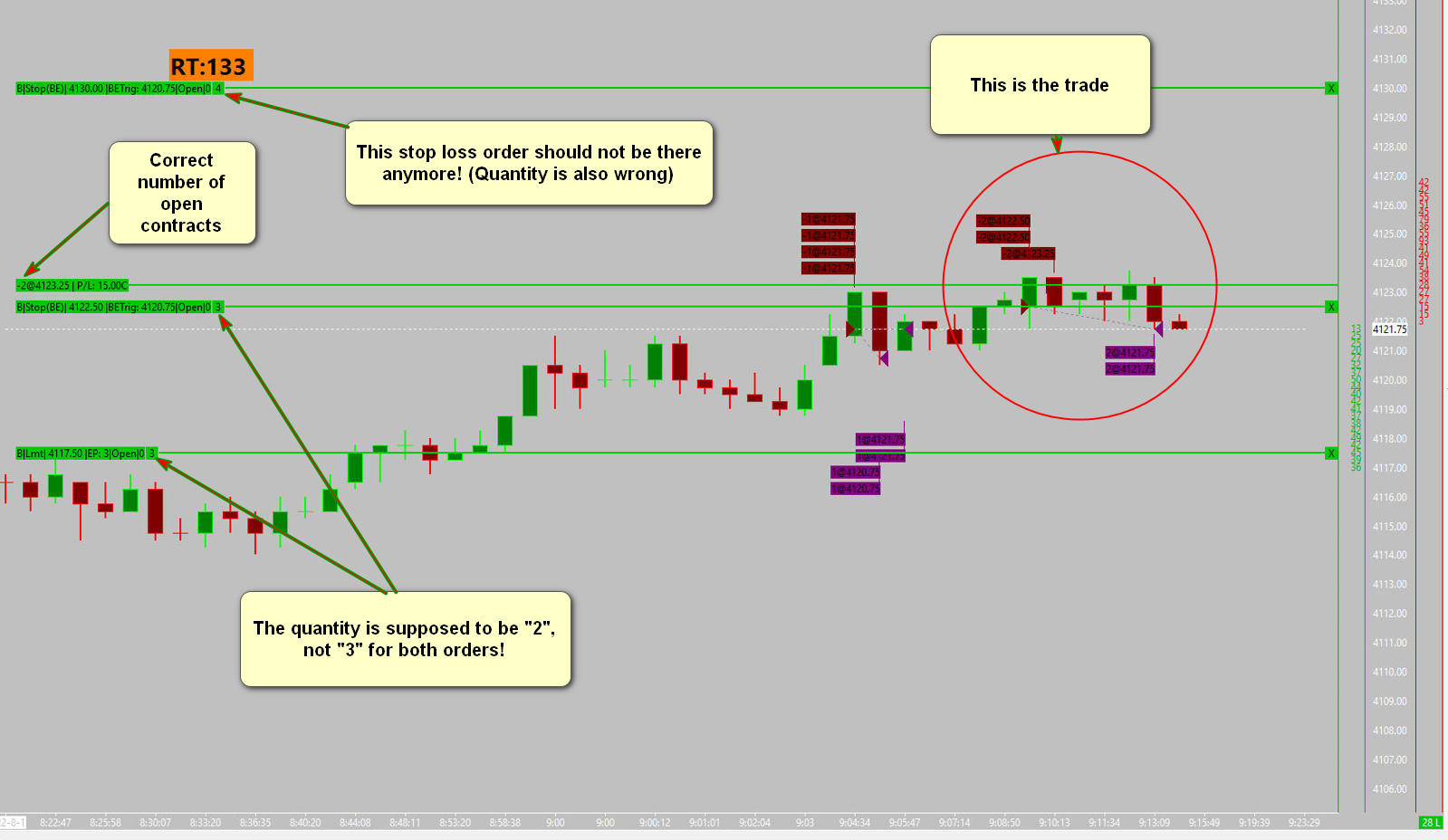

I copied with factor 2 ("Allocation Trade Account Multiplier") from the original chart. 4 contracts were filled on the initial entry and then 2 more were scaled in on one occasion, so I ended up with 6 MES contracts in the chart/account that had the issue.
So far so good.
After 4 ticks of profit were reached (the first target), 4 of those 6 contracts got filled and the stop loss of the remaining 2 contracts was supposed to be moved to break even +1.
In the orginal chart that worked fine (just with fewer contracts); however, in the chart of the account I copied the trade to I was pretty surprised to see that the SL had moved to BE+1 (based on average entry price), BUT there was still another SL order present at the original location (30 ticks above the initial entry price).
PLUS, the contract quantities were totally wrong everywhere! There were only two open contracts remaining, so, there should have been a quantity of 2 in the (proper) SL order and also in the limit order at the next profit target.
However, there were 4 contracts sitting at the "original" SL position, 3 contracts at the moved "BE+1 SL", and 3 contracts at the limit order at the next target! I had to quickly change the quantities manually!
I attached a screenshot with annotations to illustrate the issue.

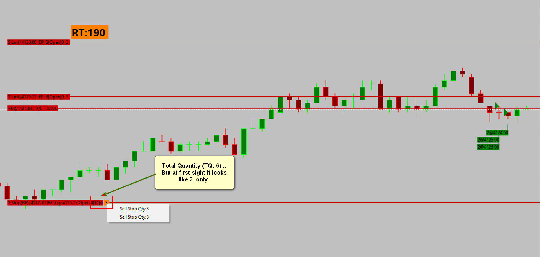

After the scale-in (again a total of 6 contracts being on then), I saw a "3" on the right side of the stop loss order, where usually the quantity of contracts of the order is displayed. So, at first I thought there's an issue again, as the quantity does not match the number of open contracts.
But then I looked closer and it turns out that to the left it said "TQ" (Total Quantity?) "6". When I then hovered across the "3" it showed a split of 3 and 3.
May I ask on this occasion what that is supposed to be? Does that mean that if I drag the SL order with the mouse (haven't done it), only 3 contracts of that order will be moved at a time?

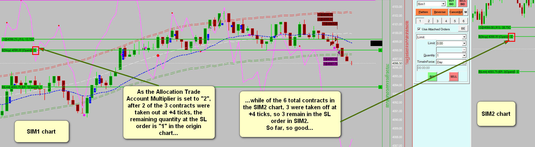

I took another SIM trade with scaling-in and copying the trade from SIM1 to SIM2 (multiplier 2) today.
And while I could not reproduce the exact same issue described in my initial post, there was still an issue with wrong quantities after I moved the SL in the origin chart manually to lock in more profit after the 1st TP at +4 ticks had been hit earlier. (The prior automatic movement of the SL to BE+1 did not have that effect.)
As soon as I moved the SL manually in the origin chart, the SL location was also changed in the SIM2 account...
BUT, instead of keeping the correct former quantity of 3 contracts being protected by the SL, the quantity was reduced by 1, so that only 2 contracts were left protected!
After another manual move down of the SL, when it eventually got hit, I therefore ended up with one contract still remaining open, but being unprotected now (no more stop loss in place)!
So, something is obviously wrong with the SC trade copier. It seems that multiplying the traded contracts by means of the "Allocation Trade Account Multiplier" leads to several problems.
(I have never had similar issues so far in accounts to which I copied using multiplier "1".)
I attached three pictures, which show how the SL contract quantity got changed and the unprotected remaining contract in SIM2.
