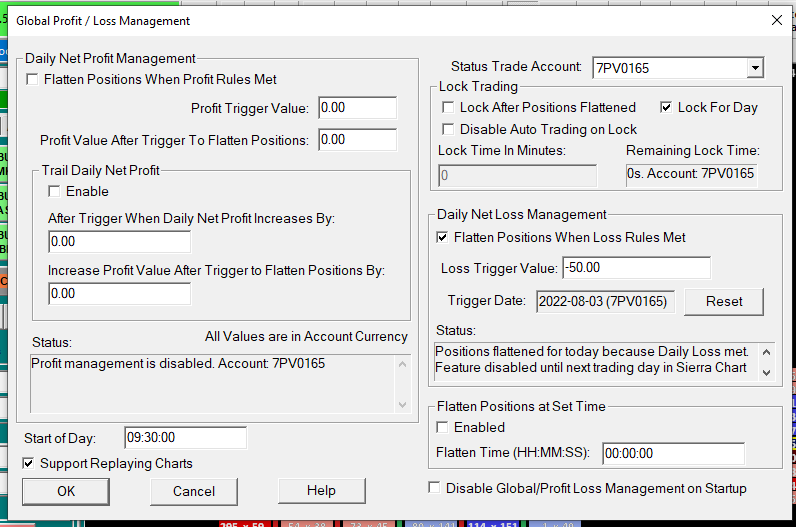

[2022-08-03 18:43:53]

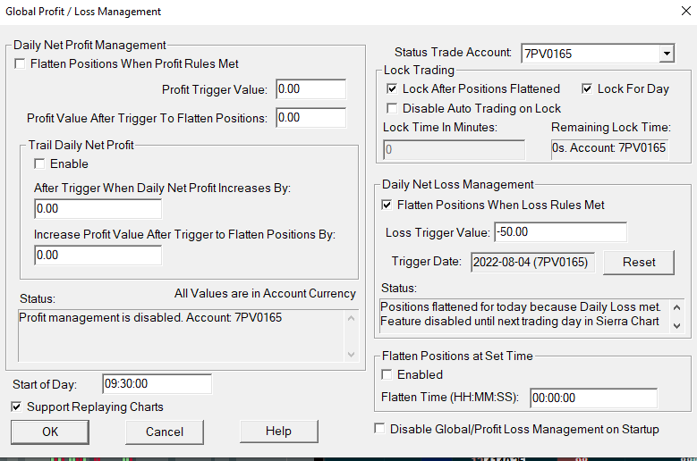

We would need to see an image of your Global Profit/Loss settings in order to ensure that everything is setup properly.
[2022-08-03 18:57:29]
Steve Leon - Posts: 319
I am seeing under status that the Positions flattened for today ...
However my positions do not seem to be flattened when i get past the set threshold (in this case -$50) and it allows me to continue to keep placing orders and letting them get filled without flattening them.
See what you requested as attached
Thank you
imageSC Global Profit and Loss.PNG / V - Attached On 2022-08-03 18:57:22 UTC - Size: 46.08 KB - 398 views
[2022-08-03 20:28:40]
Everything looks correctly setup. Although interestingly, it is showing that you hit your maximum loss limit for the day. Did that work properly for you this time?
[2022-08-03 20:32:49]
No thats the issue. It does not liquidate my position above the threshold and then I am able to keep trading through the loss limit ?
[2022-08-03 21:59:17]
If it flattened when you hit the -50.00 limit, but did not lock trading for the day, then that is because you need to enable the option for Lock After Positions Flattened (we did not notice this earlier).

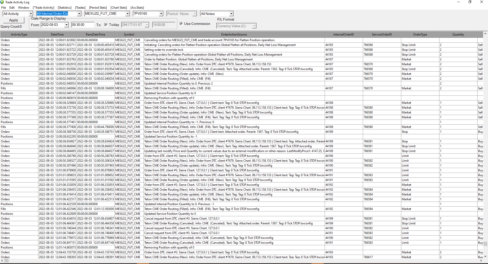

[2022-08-03 22:39:17]
Previously you had sent the Trade Activity Log, but looking at it, we do see the following a few times:
Trade Order Error: Insufficient Account Value For Margin For Order
We do not know for sure if this is related to the Flatten command from the Global Profit/Loss Management, as we can not see all of the information, but take a look at those lines and see what they state.
[2022-08-04 00:38:14]
So I found the flatten orders in the Trade Service Log (attached screenshot).
I wound up with PnL of -168; although I had set Loss Trigger Value to -50.00. Is this because Lock after positions Flattened was not checked ?

[2022-08-04 13:36:05]
We are not sure when your PnL went to -168, but the one thing we see is that you were not locked out of trading (this is why you needed the option for "Lock After Positions Flattened" to be enabled), so you would want to see if your PnL was close to -50.00 right when the Flatten occurred and not at the end of the day.
1) If you are using an Automated Trading system, then you would want to also enable this option. It just ensures that any automated system will be stopped from being able to place trades.
2) If you have the "Lock After Positions Flattened" in combination with the "Lock for Day", then you would be locked out until the start of the new session for the day. Refer to the following:
Global Profit/Loss Management: Lock Trading (Global Settings >> Global Profit/Loss Management)

[2022-08-04 15:31:04]
As an addendum
i noticed that the flatten trigger loss occurred at -100
This is what it is set at on the main instance. It is set at -50 on subinstance 3
perhaps it uses the main instance only to determine this ?
i then restarted the platform
the lock trading for day and lock after positions flattened were checked on both main instance and subinstance #3 (that i am using for trading)
i was still able to enter orders which i was not able to earlier in the day as mentioned above at the start of todays thread
Thank you
[2022-08-04 15:41:46]
Since you are using Sub-Instances, you would need to have the Global Profit/Loss set the same in all instances. A sub-instance does send the orders through the main instance, so having the main instance set the way you want is critical. It will also be necessary for the main instance to lock the trading.
