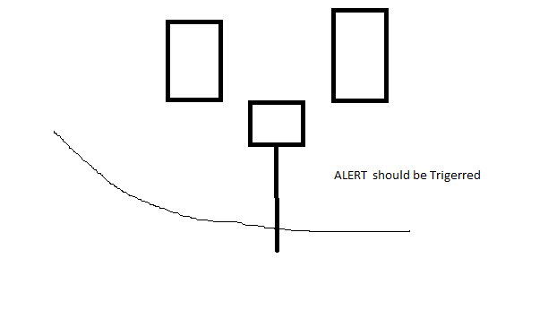

User361939 - Posts: 170
Thank you, but still it is only showing alert when price cross.
What should be in formula to cover case i attached?

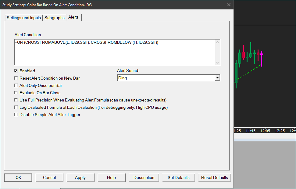

The formula I gave in post #2 will alert when the Low crosses the MA, with the setting used in the attached pic.
Put the formula on the Alerts tab of the Color Bar Based On Alert Condition study so you can see where the alerts occur.
