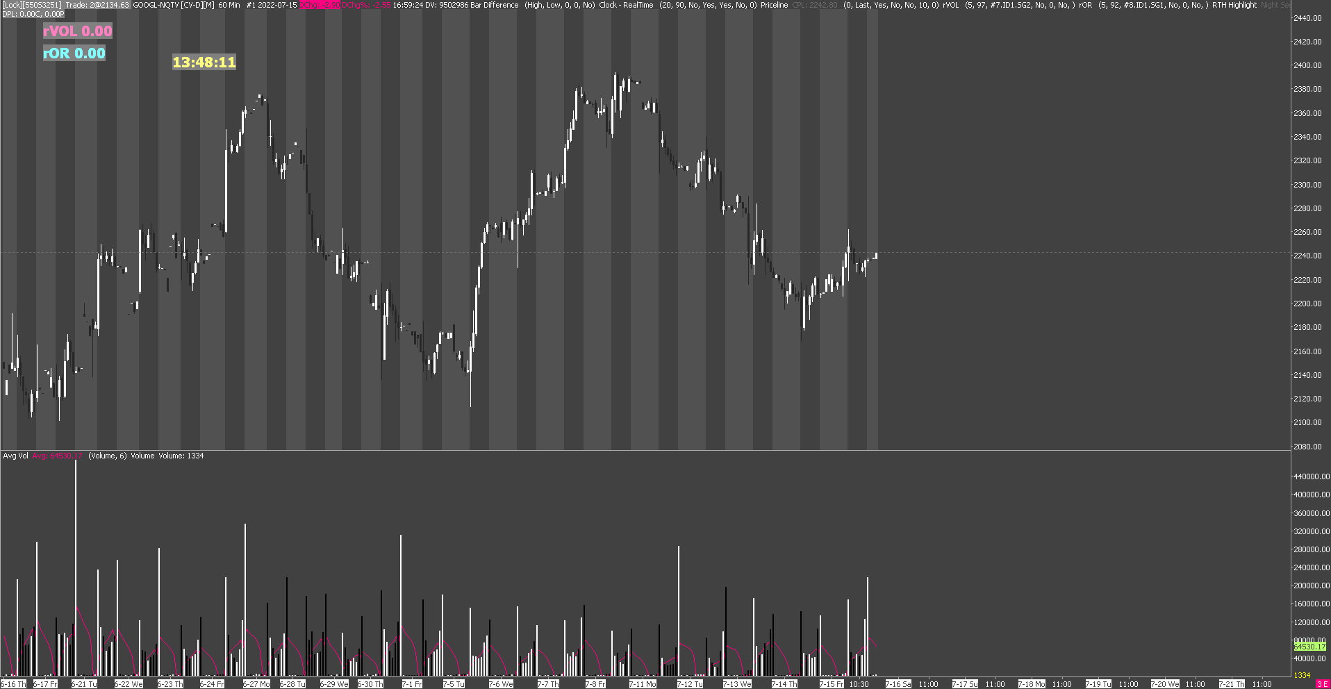

Oh damn.. You're always on the ball, John! I think I've been staring at futures for too long. Haven't played around in the Equity world much. Thanks for clearing that up for me! However, the problem does persist with GOOGL. I've tried both GOOG, and GOOGL, but the data stops loading on July 15th. This isn't happening with any other symbols that I'm looking up, even if they've never been loaded before.

Well, it did seem to work on Instance 1, however on instance 2 the data stops on July 15th. Does this have something to do with the stock split?
[2022-07-21 21:31:14]
John - SC Support - Posts: 48504
It will not have anything to do with the stock split. After all, you are getting the data on one instance, so you should be getting it on the other instance.

Alex Q - Posts: 119
I have one installation on this computer, and I am running a sub instance.
But, I do think I have figured out how to remedy it: I cleared all studies off of that particular chart, and then the data post-split decided to show up. I was then able to add the studies back to the chart, and the data remained. Some type of conflict with the studies and the post-split data. Interesting 🤔
[2022-07-21 22:03:09]
Alex Q - Posts: 119
In conclusion: I needed to remove all studies to get data to load. I then had to adjust the data for the 20:1 split. Once I did that, things seem to be working seamlessly across all time frames, with my studies added back.

Alex Q - Posts: 119
None, they are all from within Sierra. I was using a study-set that I had built on another chart book. Things that had data coming from other charts such as Study price overlay. There seemed to be a conflict between the candlestick/price data post-split and some of the studies on the chart. Can't pin-point exactly what it was, however what definitively worked was clearing all of the studies. Once I did that, the post-split price data via candlesticks appeared. Then I adjusted the pre-split data to match. After that I had no issues adding the study-sets back to the chart.
