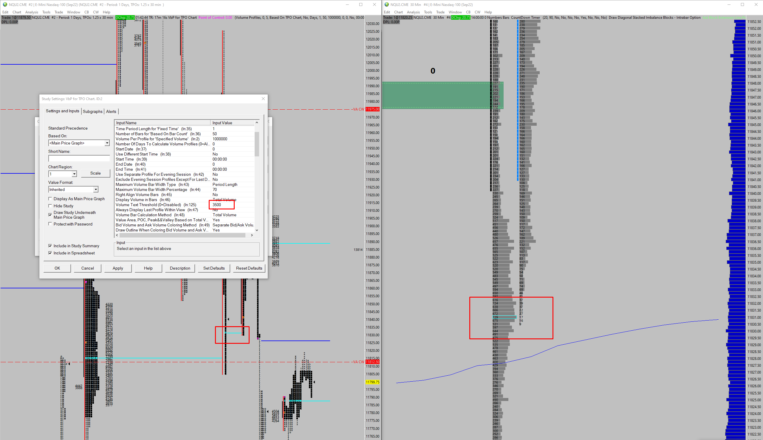

My first, serious problem. In the attached file you can see a M30 chart and a TPO chart.
In the M30, we have a volume of 729 contracts. If I try to set this on a shortened TPO chart, the calculation does not seem to add up. Multiplied by 5 (ticks per volume) , nothing is displayed in the filter at the tpo chart.
where is my thinking error? Have I forgotten something to consider?
thx for your support.

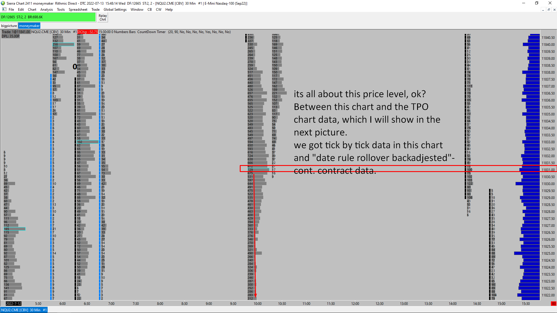

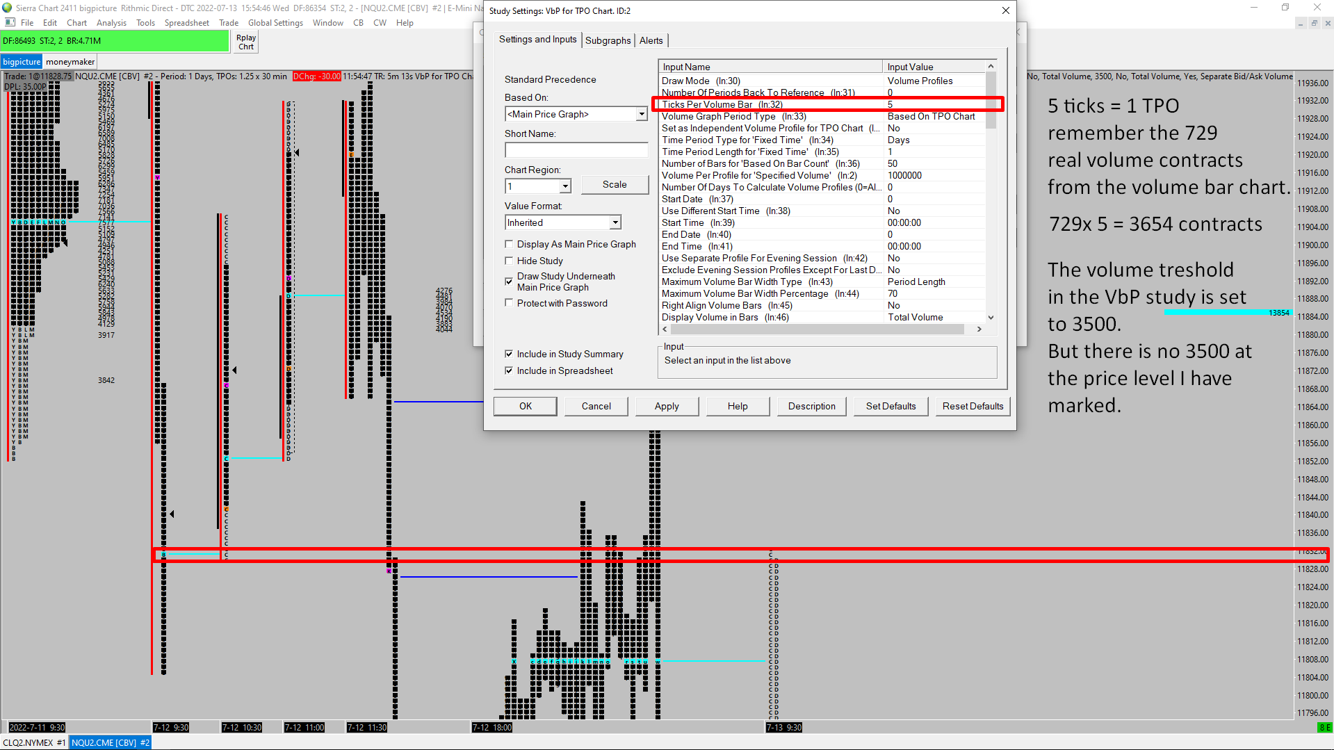

MarcOh - Posts: 178
Im sorry. :D hope it's not because of the language barrier.
please take a look at the picture in the appendix below when you are free.
thx in advence.

[2022-07-13 16:39:59]
John - SC Support - Posts: 48317
The first thing to keep in mind is that the "Ticks per Volume Bar" is not the particular volume at that level multiplied by the Ticks per Volume Bar, but is a consolidation of 5 ticks added together. It's hard to say exactly which 5 price levels are added together, but it would be something like the following:
- 531 + 675 + 729 + 672 + 666 = 3273
Turn off the Volume Filtering on the Volume By Price study associated with the TPO and you will then be able to coordinate which grouping of 5 go together. Refer to the information here:
Volume By Price Study: Ticks Per Volume Bar
