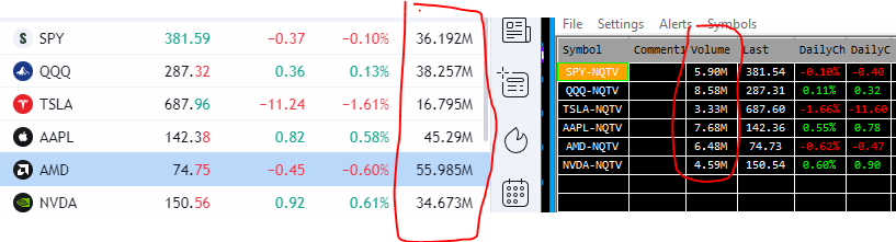

In this thread - New Important Good Information about NASDAQ TotalView Data Feed you mention the new nasdaq feed stocks would have better volume reported from Tuesday just gone. I'm still getting very lower numbers in the quote board (see screenshot), will this be fixed?

Yes, we did notice that. When we thought the volume would be higher or equivalent to the consolidated tape for NASDAQ stocks it was based on the first minute of trading at 9:30 AM US Eastern time.
We do notice more volume then but not after.
The volume data that you see is what is being provided by NASDAQ TotalView.
We are working on the full consolidated tape volume data. This is not yet available.
