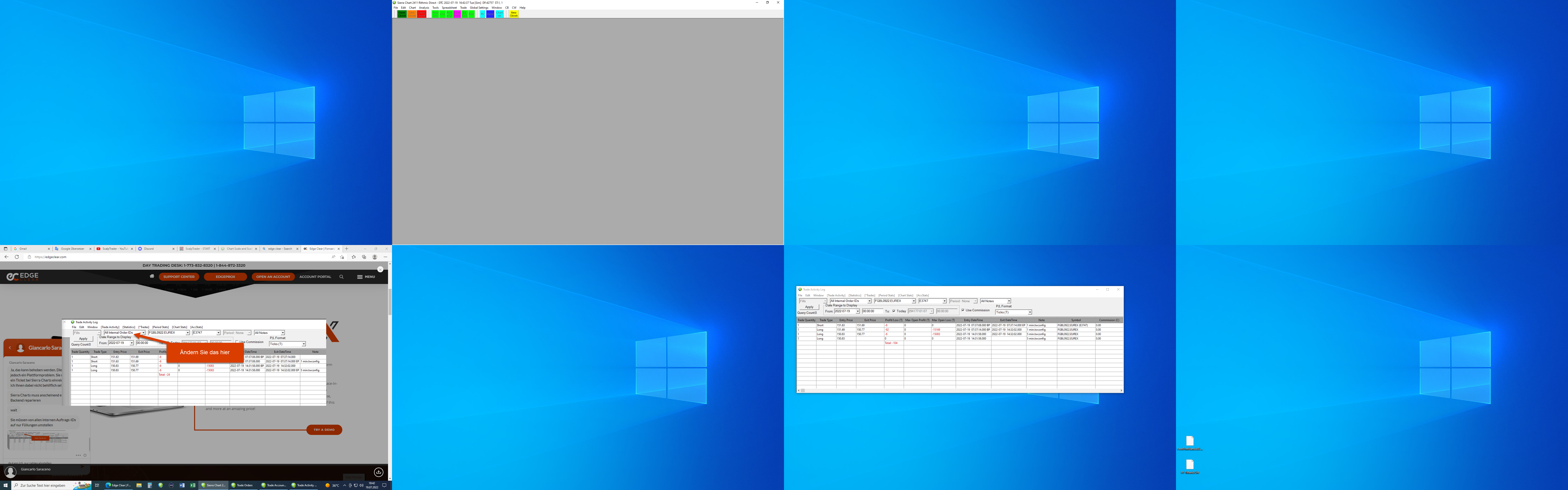

Today I traded the FGBL for the first time via rithmic broker edgeclear. I made two trades with a loss of 6 ticks each. Thus a total loss of 12 ticks. in the
Trading window in the Sierra chart, the trading window shows me a loss of 104 ticks. I have the same in the Trade Activity Log (see picture) what's wrong there?

Ich habe heute das erste mal den FGBL über rithmic broker edgeclear gehandelt . ich habe zwei Trades gemacht mit jeweils 6 Tick Verlust . Somit Gesamtverlust 12 Tick . Im
Handelsfenster im Chart von Sierra zeigt mir das Handelsfenster einen Verlust von 104 Tick . Das gleiche habe ich im Trade Activity Log (siehe bild ) was ist da falsch ?

[2022-07-19 19:59:38]
Are the fills correct? The number of fills, the details of the fills? Are they being matched correctly? We do not know what is right or wrong from the screenshots. There is no way we can know. Only you can know.
Follow through the instructions here:
Trade Activity Log: Trades Tab
Date Time Of Last Edit: 2022-07-19 19:59:58
