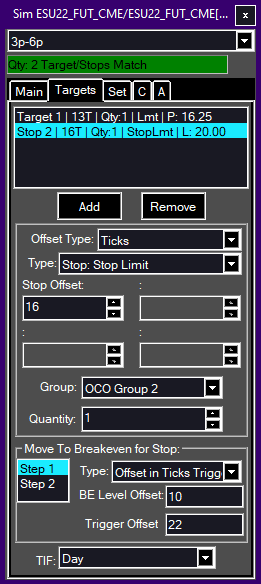

TradingInDemand - Posts: 29
@john My second target is a runner that after 6 points can not turn red on me because the stop would move to 106 and I would manage the trade for how I see fit.
The screenshot is how I have it now but it does not move the stop like you have explained. Maybe I have the BE level offset and trigger offset confused but anything helps

[2022-06-27 17:28:18]
The way you have it is that after 24 ticks of profit, the stop would move to the Breakeven + 1 tick.
[2022-06-27 19:53:25]
What I ended up doing for anyone that has the same question
