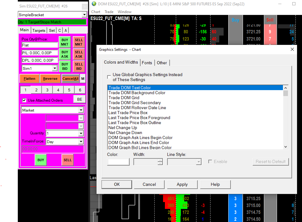

Not sure if the uploaded the file or not. It said it was "uploaded" but I don't see anything indicating it is attached. Regardless, the Use Global setting IS NOT CHECKED on the Chart / Graphic Settings - Chart for the DOM.
imageDOM issue Image 1.PNG / V - Attached On 2022-06-20 21:09:35 UTC - Size: 70.36 KB - 650 views
[2022-06-20 21:22:39]
The image is attached and helps us.
So the main thing is that the option for Use Global Graphics Settings Instead of these Settings is not enabled (as you state). As such, you need to change the color options for the Trade Window through the Chart >> Graphics Settings. This also means that you have to make the change to the correct chart to which the Trade Window is associated.
