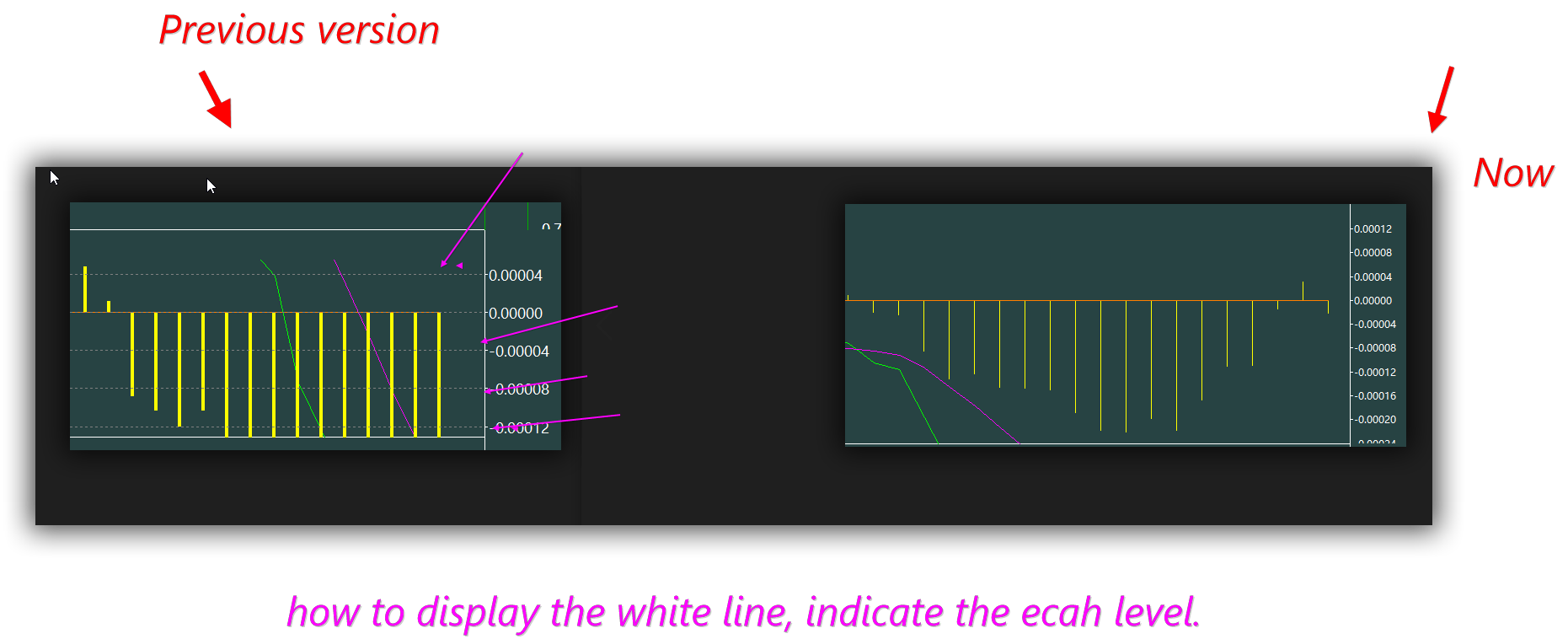

Hello John:
According the setting before i used, and the studding setting is as same as before, why can not indicate the horizonal direction. For example ,CA, 0.00000, it hasn't Horizontal line.so how can i have this line,
before, 0.00002 0,00004..... each number has the Horizontal line indication.

[2022-06-20 02:32:01]
User359273 - Posts: 31
https://www.sierrachart.com/image.php?Image=1655691872606.png
I upload the previous chart, you just see the MACD, each level has the white line to indicate. how to display the white line 0.00004 0.00008...
The version i am using now , it is not has the white line , so i want to know how to display it, and the study is as same as before .
imageMACD line.png / V - Attached On 2022-06-20 02:18:39 UTC - Size: 90.39 KB - 207 views
[2022-06-20 14:42:44]
Those are Grid Lines and have nothing to do with the study itself. Refer to the information here:
Chart Menu: Horizontal Grid (Chart menu)
