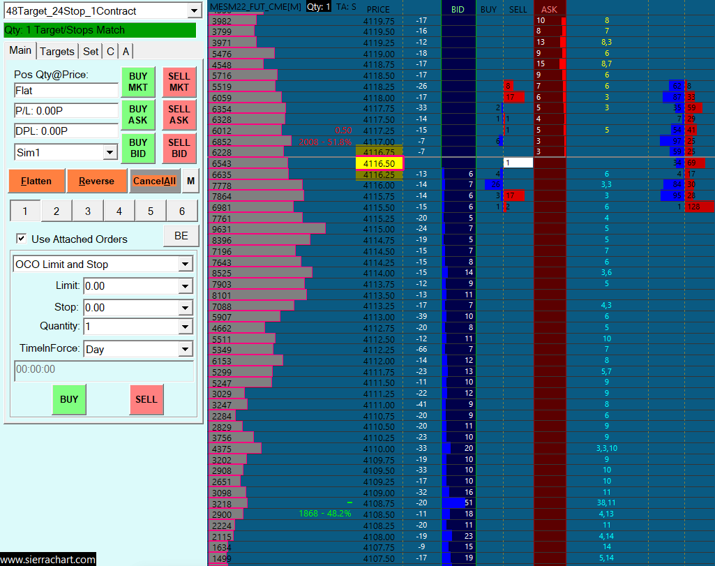

I enabled the DOM Depth Total and DOM Depth Percentage at Chart DOM Setting. My question is, is there a way to see both the Total and Percentage maybe at the middle of the DOM instead at the very end of both Bid and Ask side so that I don't have to scroll the up or down? Thank you...

The DOM Graph comes close to what you want. If you enable the options for Only Single Level with Greatest Volume and Show Volume Totals and Percentages then you will often get the numbers showing close to the center. But, it will depend on where the largest Market Depth is, so it could be further off. But give it a try and see how it works for you. Refer to the information here:
Chart Settings: Draw DOM Graph On Chart (Chart >> Chart Settings >> Market Depth >> DOM Graph menu)

I did the "single level with greatest volume" and it's close enough. Not great but it will work okay, better than scrolling all the way up or down.
https://www.sierrachart.com/image.php?Image=1654723573667.png
