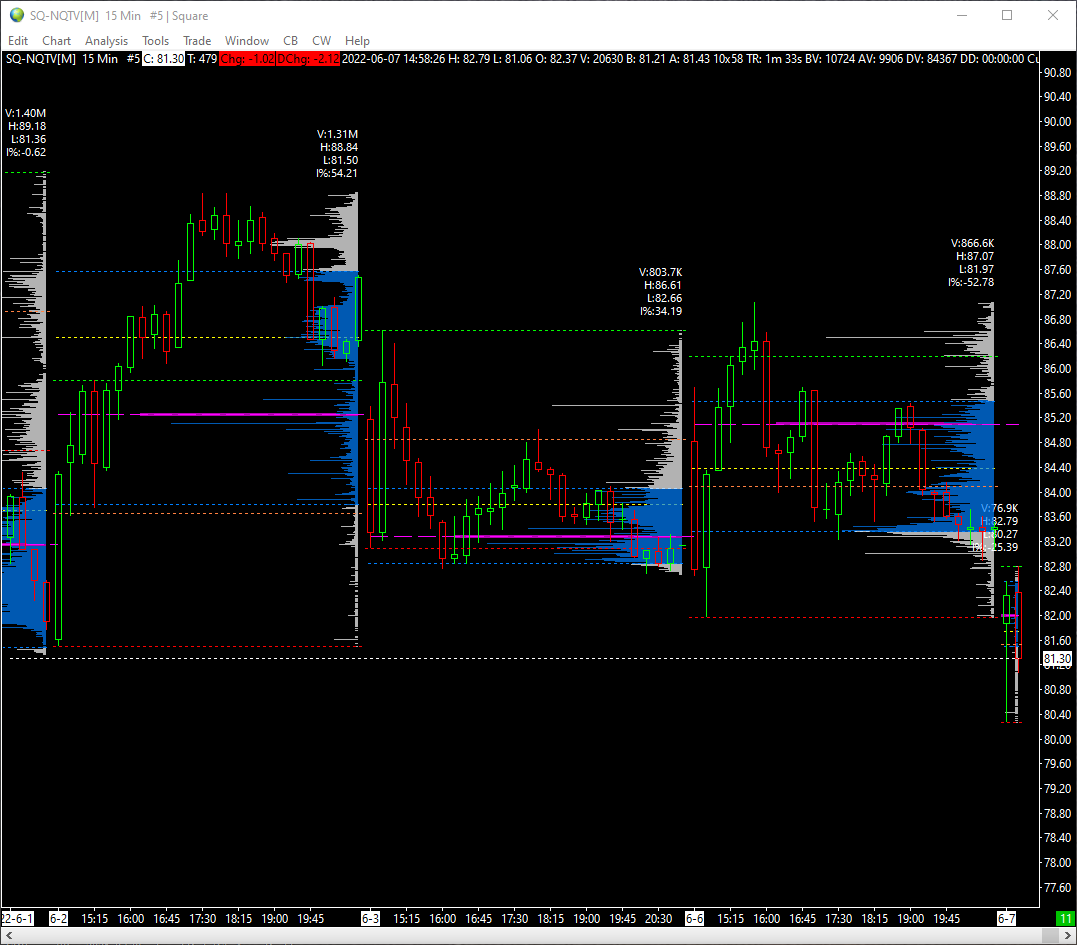

The price updates on my current price line for my nasdaq charts (specifically sq-nqtv) are very slow and therefore inaccurate.
The current price line does not reflect time and sales trades and it appears is therefore not building an accurate volume profile.
If this does not correlate with tick data then it is useless.
I have checked cross setttings with futures products, which are working.
Nasdaq charting is way off.
Please help.
Thank you.
image220607 sq-nqtv.PNG / V - Attached On 2022-06-07 13:59:47 UTC - Size: 71.85 KB - 228 views
[2022-06-07 15:37:25]
John - SC Support - Posts: 48151
What we think you are running into is that the NASDAQ TotalView data is not the full consolidated tape for the equities. It is just the primary exchange volume data.
We are working on having the consolidated tape available.
The other option is that you can use the U.S. Equities exchange on our Sierra Chart Exchange Data Feed, which does have the consolidated tape volumes, but it does not include the Market Depth data. Refer to the Setup Instructions for this here:
https://www.sierrachart.com/index.php?page=doc/SierraChartRealTimeFuturesStockDataFeed.php#SetupInstructions
