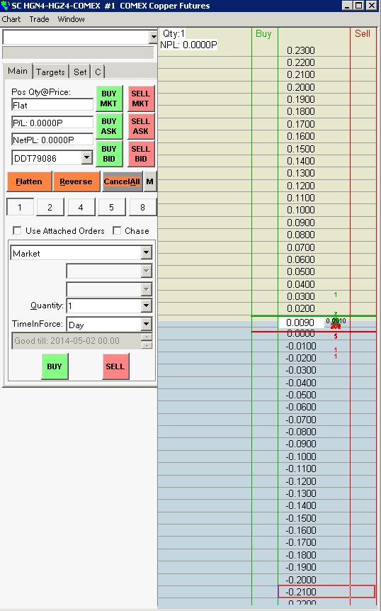

I have issue with Copper spread with Rithmic. Using this syntax "HGN4-HGZ4-COMEX" I can get spread DOM opened but market depth looks strange (see attached picture). I tried also for example Crude Oil spreads and that works OK.

imagerithmic_spread_market_depth.jpg / V - Attached On 2014-05-01 18:38:00 UTC - Size: 116.3 KB - 681 views

There were incorrect settings in DOM -> Chart Setting. Had to change Tick Size (set to 0.01) to correct value 0.0005
I can manually correct setting for required spread each time but can you somehow fix this?

Yes, clearly the Tick Size was wrong. It should be automatically set based on data from Rithmic but that might not be working correct for various reasons.
The most reliable thing to do is to set up this symbol with the proper tick size in Global Settings >> Symbol Settings:
HG?#-HG?#-COMEX
Be sure to enable Use Pattern Matching.
You need to look up the spread symbols in the Rithmic trading software and use exactly what you see.
