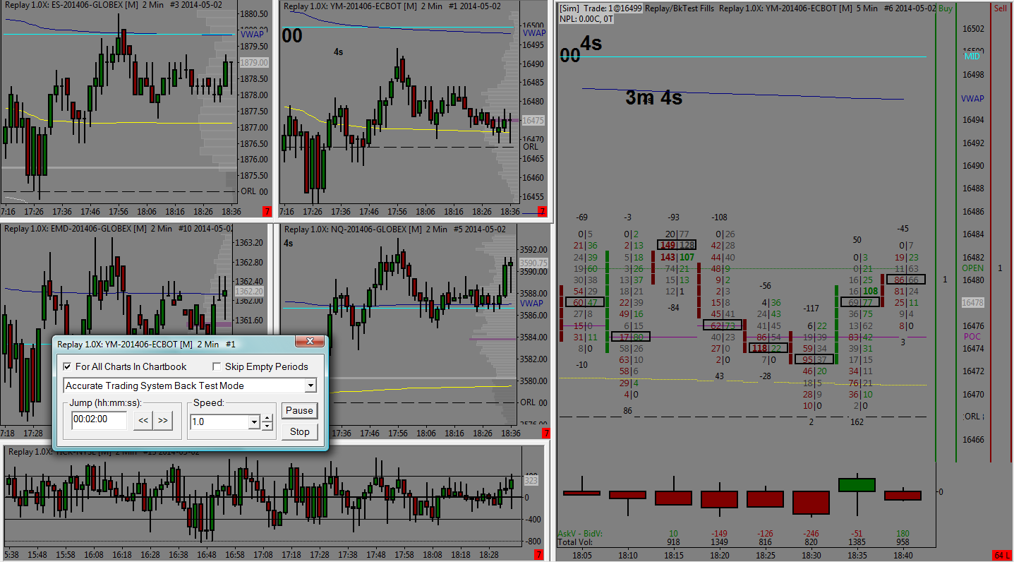

[2014-05-03 10:02:12]
Bluefruit - Posts: 41
Please, have a look at the attached file.
There are two charts showing the YM futures contract. The middle upper chart is a 2 minute chart, the numbarsbar is a 5 minute chart.
In both charts a countdown timer is implemented. One countdown timer per each chart.
Unfortunatelly, the 2minute count down timer is copied onto the 5minute chart and vice versa.
Settings>
1132 version / Sierra Chart Data Feed / Interactive Brokers / Chart Replay mode
image1.png / V - Attached On 2014-05-03 09:58:54 UTC - Size: 134.83 KB - 578 views
[2014-05-03 10:53:21]
On the rightmost chart, the larger one, select Tools >> Erase All Text.
Does that remove all of the countdown timers? It will remove the one added by the Countdown Timer study on the chart, but you can get it back with Chart >> Recalculate.

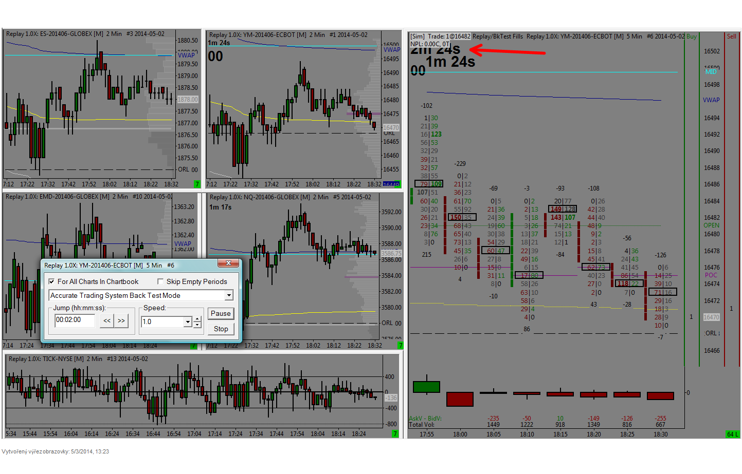

[2014-05-03 11:32:09]
No, it doesnt remove all of the countdown timers.
The countdownt timer related to this 5 minute chart disappears for a moment. Then it goes back to the very corner of the chart (see arrow at the attached image)
image2.png / V - Attached On 2014-05-03 11:31:24 UTC - Size: 161.35 KB - 603 views
[2014-05-03 11:38:57]
We need to think about this. But the solution for now is to remove the Countdown Timer studies from the charts and re-add them.
