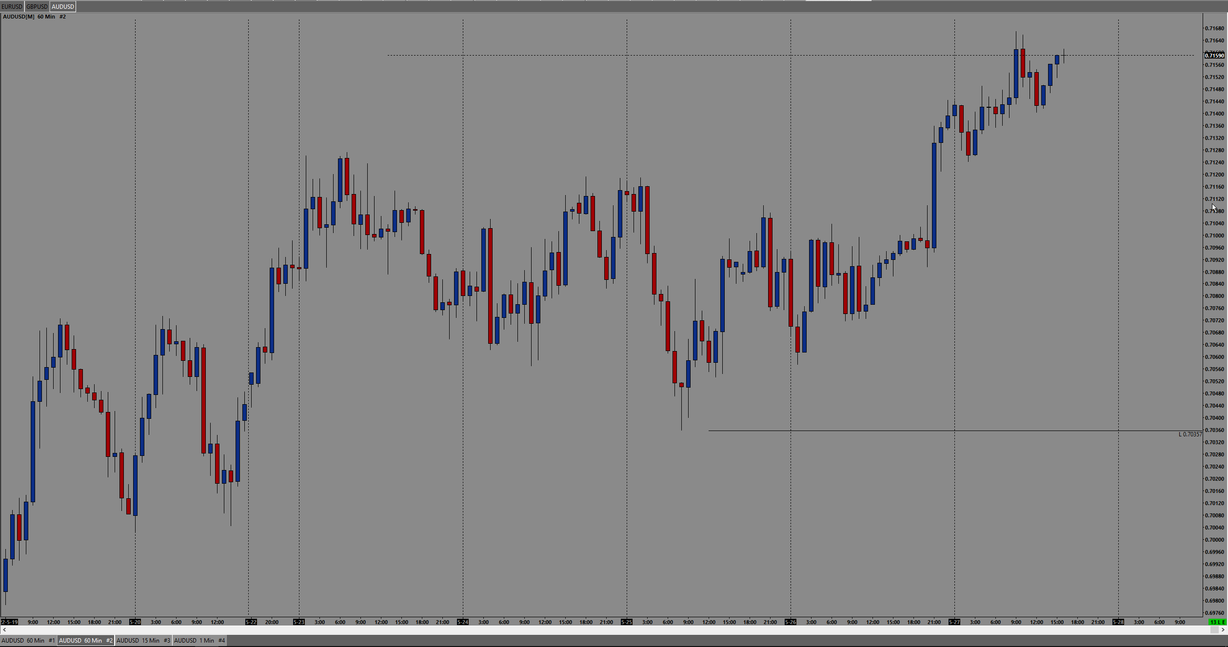

I have a problem with transferring OHLC horizontal lines from D1 graph to ingeririoi graphs.
If I insert a horizontal OHLC line on a D1 minimum and transfer it to, for example, TF H1 I get the line starting from the next day of D1.
If, on the other hand, from the D1 chart I drop directly to H1 the line starts at 12:00 noon on the same day.
As you can see, the line in graph #2 is not reported correctly.
If, on the other hand, I go from D1 on chart #2 to H1 also on chart #2, the line is on the same day but does not start at 00:00:00
Is there a specific solution to this?

First it does not make any sense to be using the Session Times you are. There are going to be unusual problems when you have both the start and end time set to 00:00:00.
No not in this particular case. But we will see if we can look at making this the start of the trading day according to the Session Times of the destination Intraday chart.

In the screen there is an error in the time.
Once I do apply sierra chart it corrects so my time is 00:00:00 and 23:59:59.
This will be implemented in the next release. Wait until the next release to see if the issue is resolved for you.
