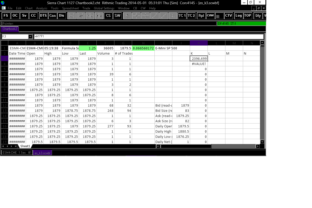

[2014-05-01 10:41:29]
User69798 - Posts: 3
Reference work, Thank You
Now problem inside sheet, look at the picture please
Row1 is original only from Quote Sheet, other row and column replaced during Study entering process,
so formula in error
Date Time Of Last Edit: 2014-05-01 13:17:07
imageSierra_1.png / V - Attached On 2014-05-01 10:38:44 UTC - Size: 64.05 KB - 576 views
[2014-05-01 20:01:20]
This is why we previously said this:
You will want to use the Chart Data Output Sheet Number input to control which Sheet the data is outputted to so it does not interfere with the Quote Spreadsheet.
You need to have the chart use a completely different Sheet within the Spreadsheet. You can use sheet cell references to reference the data on another Sheet within the Spreadsheet window.
