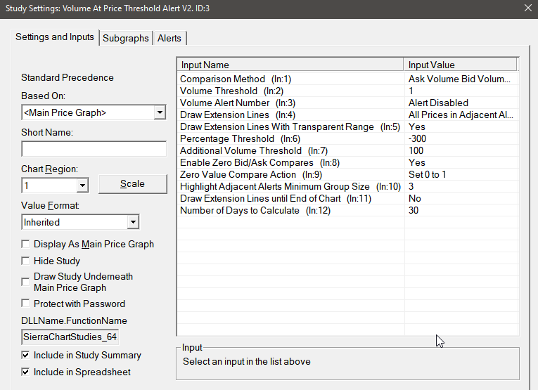

im using "Volume at Price Treshold Alert V2" for showing me grouped stacked imbalances within the chart with greater/equals 3 imbalances.

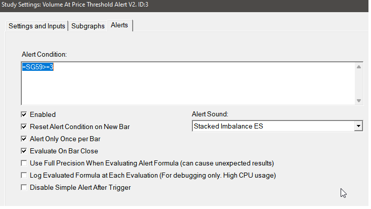

Now i want to get a sound alert if a stacked imbalance occures.
I tried it over "=SG59>=3" alert condition but it seems that the alert evaluation ignores the grouped aspect of the condition.
Is there a way to achieve it?
imagestacked imbalance.png / V - Attached On 2022-05-26 12:25:58 UTC - Size: 32.6 KB - 457 views
imagestacked imbalance alert.png / V - Attached On 2022-05-26 12:26:06 UTC - Size: 15.24 KB - 477 views
[2022-05-26 15:30:27]
John - SC Support - Posts: 48597
You were close, but not quite. You just need to check the "Top" subgraphs of the Adjacent Alert Highlight and see if they are non-zero (true). For a single (first) group, you could just enter:
=SG50
If you want to alert each time there is a grouping, then you would need to use an OR and put the following:
=OR(SG50, SG52, SG54, SG56, SG58)
