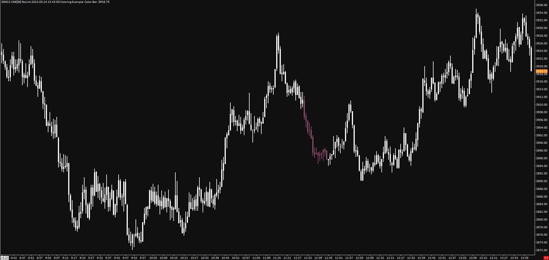

[2022-05-25 08:53:19]
User431178 - Posts: 910
Unfortunately, it won't work, it is always false.
Sorry, but how do you reach that conclusion?
Image attached showing coloring bars using that exaxt code block
imagebar coloring.png / V - Attached On 2022-05-25 08:53:13 UTC - Size: 37.64 KB - 319 views
