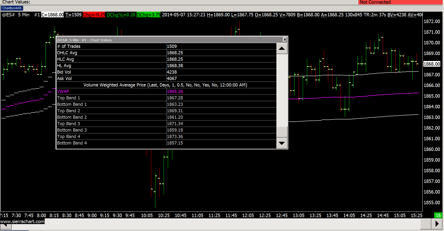

On the ES futures, comparing between 1 Number of Trades Per Bar and 1 minute, we see a difference of .02 for the Volume Weighted-average Price for the trading day.
This is very tiny. So the calculations are virtually the same.
At higher time frames per bar, there are no differences comparing between different time frames.

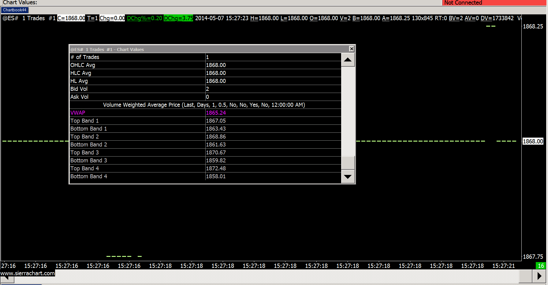

Here are the images from the testing we did:
http://www.sierrachart.com/image.php?l=1399493555234.png
http://www.sierrachart.com/image.php?l=139949383195.png
