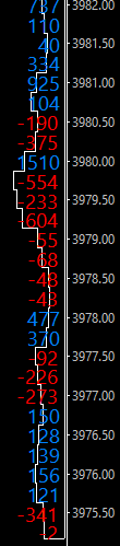

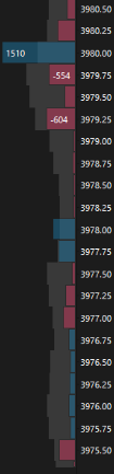

I currently have a volume profile with delta on my footprint screen which is shown in picture 1. I came across someone who uses something similar with a cleaner look (picture 2) but cannot find the exact setting to make this change. Any help would be appreciated thank you!

The general layout be the following Inputs on the Volume by Price study:
- Volume Bar Calculation Method: Total Volume
- Bid Volume Ask Volume Coloring Method: Difference of Bid and Ask Volume Coloring (or another difference option, just not the one with Full Bar Color).
- On the Subgraphs tab, change the color of Volume Bars Outline and Fill Color to the colors you want for the full volume bars.
That should get you close to what you want and you should be able to modify from there to get it exactly as you want.
Also be aware of the following inputs related to when you are displaying the Bid/Ask Difference:
Volume By Price Study: Draw Difference of Bid and Ask Volume Using Percent of Max Bar
