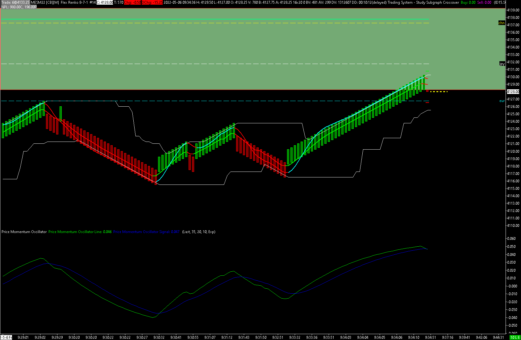

| [2022-05-06 16:47:06] |
| Ken Smith - Posts: 58 |
https://www.sierrachart.com/image.php?Image=1651855488325.png I tried to copy it with the chart studies window but it wont allow that. thanks Ken |

| [2022-05-06 21:07:57] |
| John - SC Support - Posts: 48661 |
You have the Trading System - Study Subgraph Crossover Inputs for Line 1 and Line 2 set to the same subgraph. Therefore, the trading system would never see a crossover (a line can not crossover itself). In addition, you have selected Subgraph 1 from the Price Momentum Oscillator which is the Rate of Change and is not displayed (not that it has to be displayed to use it, but we do not think this was what you intended). If you want to use the 2 lines are that are displayed by default, then those are Subgraphs 3 and 4. You would want to use one of them for Line 1 and the other for Line 2. For the most reliable, advanced, and zero cost futures order routing, use the Teton service: Sierra Chart Teton Futures Order Routing |
