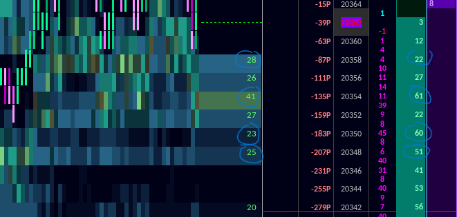

[2024-12-16 09:51:08]
MTScalper - Posts: 35
Hello, I am experiencing the same issue mentioned in this thread.
I have a DAX chart with a DOM on the chart, set to 2-tick increments, both on the chart and in the market depth. The settings for the Market Depth Historical Graph indicator are set to "Last Depth" and "Only After Last Bar", but the difference between the DOM and the indicator is absolutely misleading and, in my opinion, not very useful this way.
I’d like to understand whether I’m making a mistake in the settings or if this is normal. The chart update interval is set to 50ms.
imageSierraChart_64_rOH4p9NSd0.png / V - Attached On 2024-12-16 09:50:58 UTC - Size: 35.33 KB - 212 views
[2024-12-16 17:49:20]
On the Market Depth Historical Graph, what is the Input for "Depth Quantity Type to Display After Last Bar" set to?
