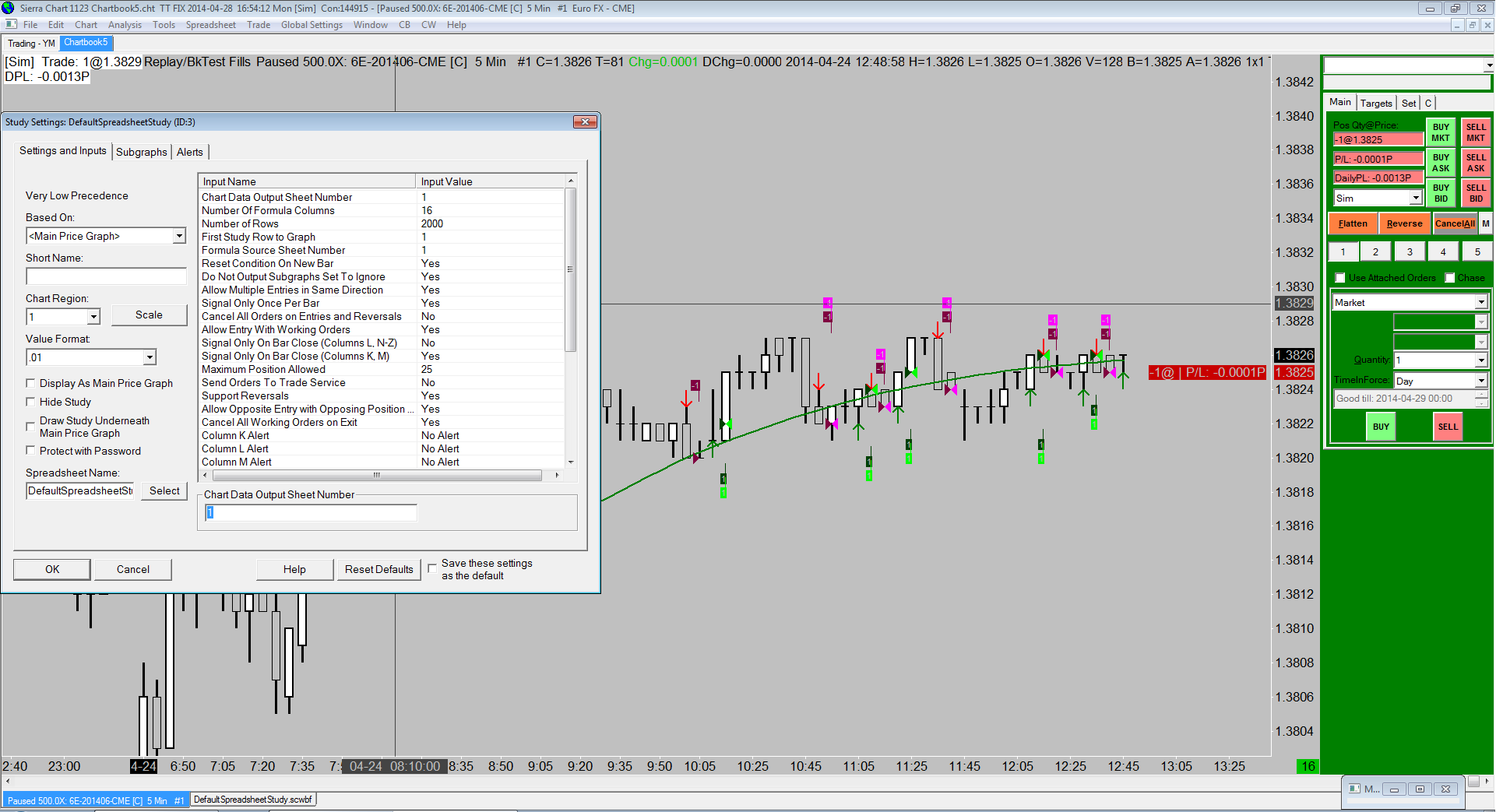

vegasfoster - Posts: 444
In K3, =AND(E3>AA3, E4<AA4)
In M3, =AND(E3<AA3, E4>AA4)
See pic for the chart settings I am using for crossover signal reversal on bar close with following formulas.
In general 1) when you look at the entry arrows on the chart are they in the correct place? If not, then you know your formulas have an error. 2) are the signals occurring on the same or different bars than the arrows? If set for entry on bar close you will typically see them on the open of the next bar, consider there could be a small gap. 3) If entries are not occurring on same or next bar from the arrow, do the 5-minute bars not have any volume? Someone correct me, but I believe if no trades occurred then nothing will happen in replay.
