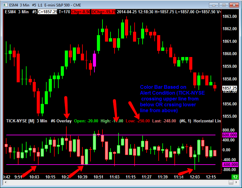

I have a TICK-NYSE chart in Region 2 of an ES Chart (the study overlay study is ID1) and Horizontal Line Study (ID2) also in Region 2. I am using the Color Bar Based on Alert Condition study and would like the bar on the main price graph to be colored when the TICK-NYSE reaches Line 1 (from below) or Line 2(from above) of the horizontal line study.
Can you tell me what I am doing wrong? I am using the following:
=OR(CROSSFROMBELOW(ID1.SG4, ID2.SG1)),(CROSSFROMABOVE(ID1.SG4, ID2.SG2))
ID1.SG4 is the last value of the TICK-NYSE Chart and and ID2.SG1 and ID2.SG2 are line 1 and 2 of the horizontal line study, respectively.

I seem to be missing some alerts though, see image. Can you let me know what I am missing?

The problem is clear. You are using the closing price of the bar. So only if that crosses will the condition be true.
[2014-04-25 17:41:21]
infpz - Posts: 826
OK. can you tell me how to base this on the last trade price instead?
[2014-04-25 18:07:46]
This is the problem. You cannot base it on the just last trade/close price. You also need to consider the high and the low.
[2014-04-25 18:52:22]
infpz - Posts: 826
I changed to overlay-single line and this is working.
