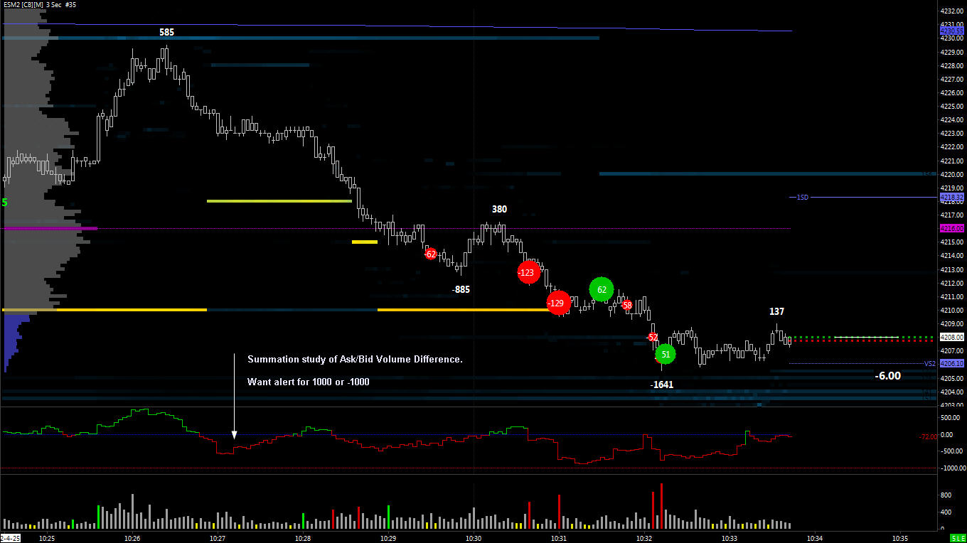

I have a Summation Study of the As/Bid Volume difference.
Would like an alert for 1000 or -1000.
Normally I would just use a horizontal line and put alert on that.
For some reason this does not work.
(I guess because it is a Summation Study)
image1mmmm.jpg / V - Attached On 2022-04-25 15:41:00 UTC - Size: 135.67 KB - 238 views
[2022-04-25 17:16:48]
John - SC Support - Posts: 48345
You should be able to use a line as you state, but you do not need to do that.
Just add an Alert to the study itself where your formula would look like the following:
=OR(ID1.SG1 > 1000, ID1.SG1 < -1000)
Where ID1.SG1 is the Study ID and Subgraph Number of the Summation Study you are using.
Date Time Of Last Edit: 2022-04-25 21:28:57
[2022-04-25 20:05:55]
User731023 - Posts: 167
Thank you. Very kind.
What should I put if I want it not just > 1000
but also less then (<) -1000 (Minus)(-1001 and so)
I tried < -1000 that did not seem to work.
[2022-04-25 21:28:46]
Sorry, we had our original post wrong with the negative. It should have read as the following:
That should work for what you want.
