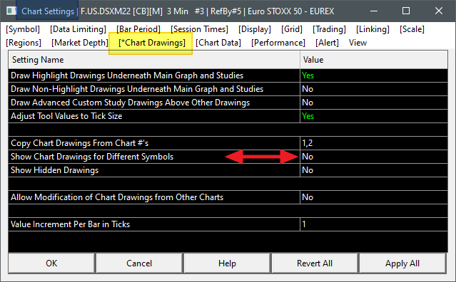

[2022-04-23 06:16:08]
nicktrader - Posts: 817
see pic for drawings
imageChartDrawings.png / V - Attached On 2022-04-23 06:15:58 UTC - Size: 20.18 KB - 277 views
[2022-04-23 13:16:47]
HumblyTrading - Posts: 226
Yes. I have that enabled.
Unfortunately, still the drawings are not showing up.

[2022-04-23 23:00:22]
This will never work because the prices are completely different between those two symbols.
